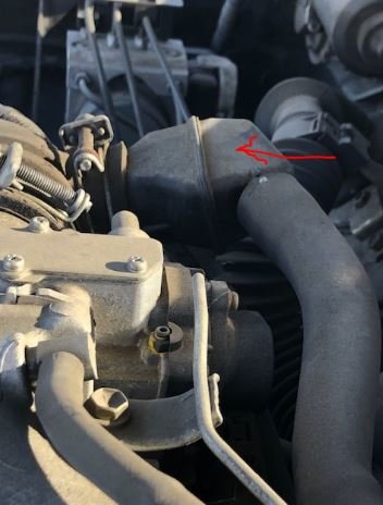

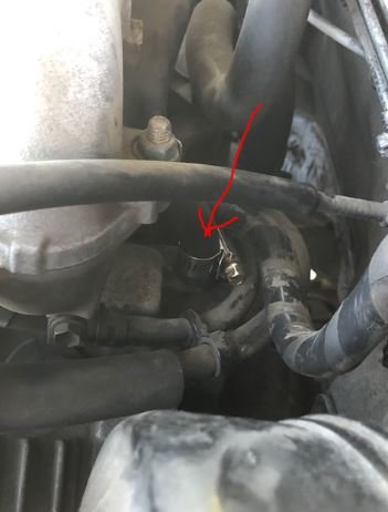

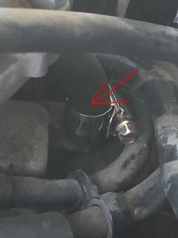

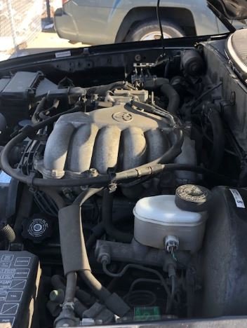

    Hi does anyone know what this hose is?
    It was cracked at the adapter and failed smog, luckily I was able to cut it short with a razor and attach it back on along with a hose clamp to pass smog test. But what is it? My original thought was PCV hose but other threads I read showed PCV valve elsewhere.. Ideas?
    photos taken from driver side over the engine bay. Hose connects into the unit in the fourth photo.

    Not from valve cover but it does go to intake. It’s in the rear of the motor.. pictures really aren’t that great. My guess is some type of ventilation though

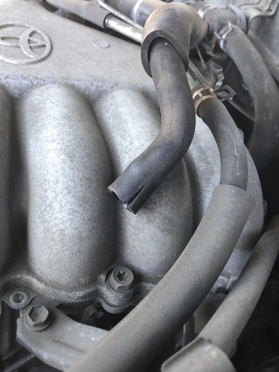

    I added the hose clamp, before it looked like this
    Wondering if I should replace the pcv valve too but sounds like it’s a different hose system

    It's part of the PCV system.
    Specifically, the "filtered fresh air source" for the system. The ventilation flow goes from the intake tube to the driver side rear valve cover, thru the engine and out the pass side valve cover at the PCV valve to enter the intake just downstream of the throttle plate. This ventilating air is drawn by engine vacuum, regulated somewhat by the PCV valve to prevent a full on vacuum leak.
    Earlier 3.4's have a smaller connector (no box) at the intake tube, like below.
    Blue is fresh air, red is the same air that has picked up or "ventilated" crankcase vapors along the way.
