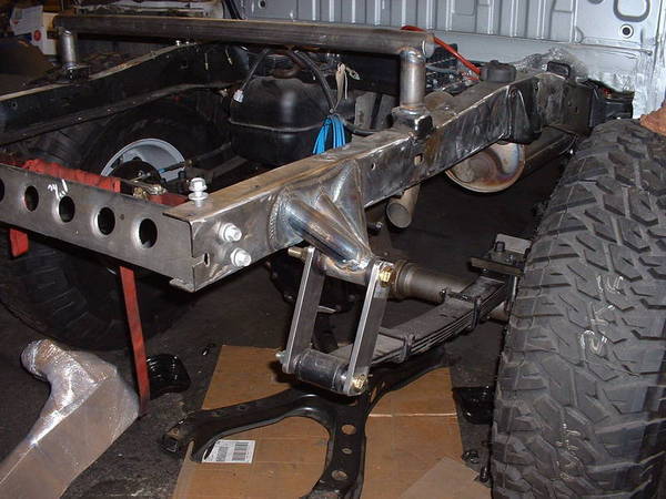

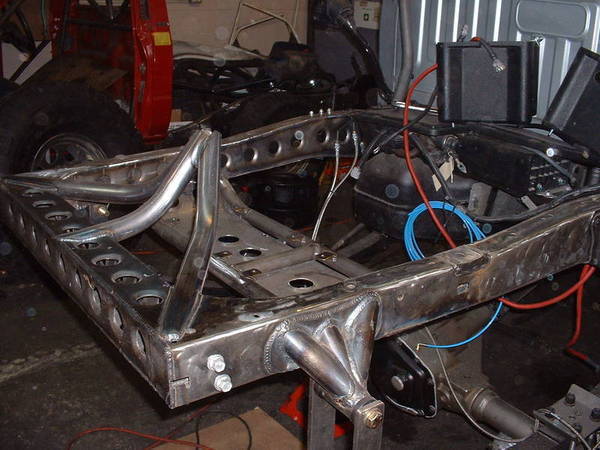

    What I find fascinating is that when someone builds a truck to take on the impossible trails they will box the rear of the frame.
    Look at Wyatt's rock crawler... He would not have done that unless he wanted to make it strong as f***!
    Before boxing the rear
    After boxing the rear
    All images link to Wyatt's truck build thread.

    Wyatt also is in SOcal no worries about rust. A rusty boxed frame < Not rusty C frame.
    Oh and thats not over kill... look at the full truck
