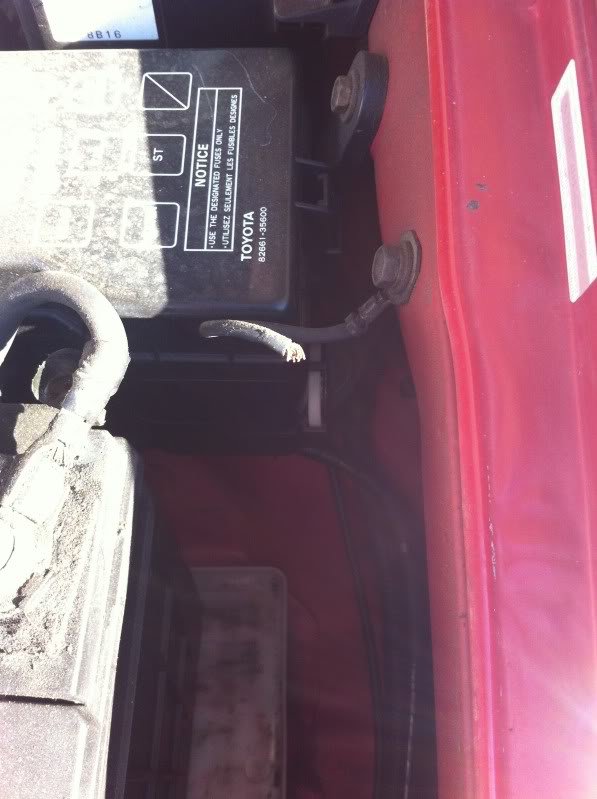

    I just noticed this when checking my oil. I'll admit I'm not the sharpest leaf in the drawer but I think I would have noticed this before today as I do regularly check my oil between changes.

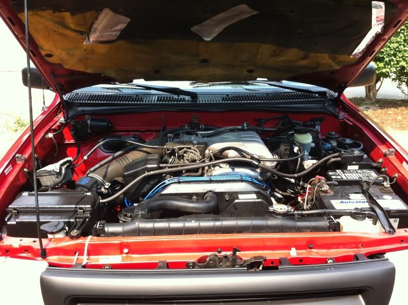

    I only have one picture prior to today that shows that part of the engine bay but it is not conclusive enough.
    Here's what I am talking about:
    Here's the only glimpse I have of it before:

    Looks like the ground that should go to your negative battery connection

    ^this.

    that's a ground...
    should be two neg. wires coming off the neg. terminal.
    one goes to the fuse box... the other grounds to the fender wall.
    ^ X4 I guess...
    in the first pic it looks like there might be two cables on the terminal ?
    possibly someone changed/extended the ground ?

    Ground for the battery.. I'm guessing it was rerouted somewhere else or you wouldn't be able to start the truck.

    That was my first reaction. It is obviously a ground, probably for the battery... but how am I starting my truck.
    I'm trying to think who would reroute my neg battery ground and why? I've had the same battery in my truck for over 10 years now.

    You have two ground wires. All that smaller one does is electrically tie the chassis ground to the battery's negative terminal. Accessories you've connected to the chassis (bolt or screw perhaps) might not work however, ground can be carried from other devices to the chassis so you may never notice.

    Well I just checked and the only thing connected to the negative battery terminal is the cable itself. It runs between the battery and the fuse box and down into a wire loom which eventually runs into a connector at the bottom of the engine.
    I do not see anything else that looks like a ground of any sort.
    I'm confused (more so than normal)

    Well that might explain why the light in my topper isn't work.
    What's the best way to tie that ground back onto the neg terminal?

    Buy a new cable.

    I just put a new battery in..
    and had to change things a little.
    so I cut the original off and extended that ground with a 4ga cable
    I'd probably replace/reconnect that...
    the more grounds the better... IMO

    But how does it attach to the neg terminal?

    The short cable was originally swedged onto the OEM battery cable. Just buy a cable that's long enough to reach the bolt side of the cable and bolt it back on.

    The same way the other cables attach.

    Well I hooked a new 4ga cable up to it. The light in my topper still doesn't work (just checked all the connections, relay/fuse, etc)
