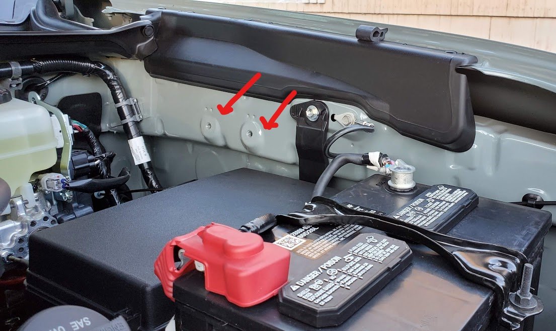

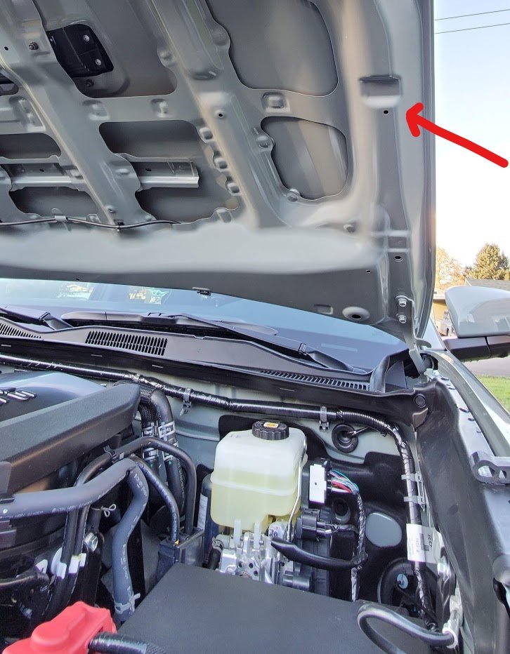

    Hey all, I was looking into getting those hood struts but always been hesitant drilling holes. I was checking under the hood to see if maybe Toyota had plans to include them, and maybe had holes ready for it. There are some threaded holes close to where the aftermarket struts wants you to drill holes, both in the hood and in the fender.
    I think it was the 4runner that had a single contact point on each end of the strut. The aftermarket wants two holes drilled out. I have attached a few photos of the holes I'm referring to. Anyone know what those holes are intended for, and could they be used for struts? Might be able to buy 4runner struts for it?

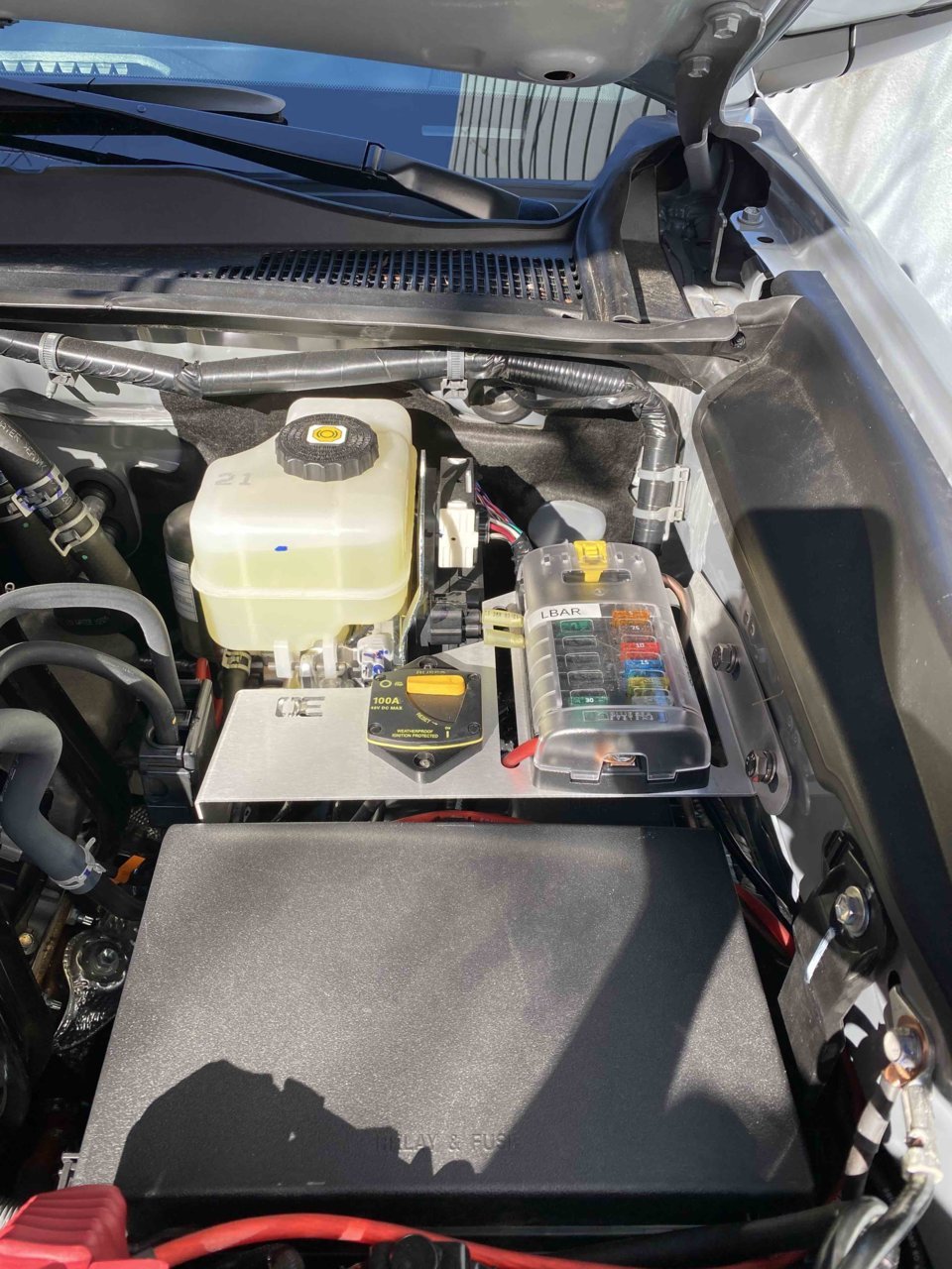

    The holes are good ground points and also used to mount brackets for accessories like an additional fuse box for all your lighting accessories.

    Holes are for the reservoir for the clutch master cylinder.

    Anyone know the bolt size for those holes?

    I believe those are m8 1.25x 30

    Those are left over from the 2nd gen structure we gave you guys.....along with our drum brakes and non locking fuel door

    They make an excellent attachment point for an oil catch can with a simple piece of aluminum as a bracket.

    I appreciate all the replies on this. Yeah I have the Sokietech struts on my list. I like them, but for some reason with how low they attach to the hood seems off to me. Like a leverage thing, I feel like any semi strong wind gust is going to cause it to slam down. I doubt they'd sell it if there was any kind of liability like that, maybe its just a visual trick on my eyes.

    I have a set of these. They use the ground point by the battery, you replace the bolt with a bolt in the kit.
    The right side has a similar hole as well but nothing is there from the factory.

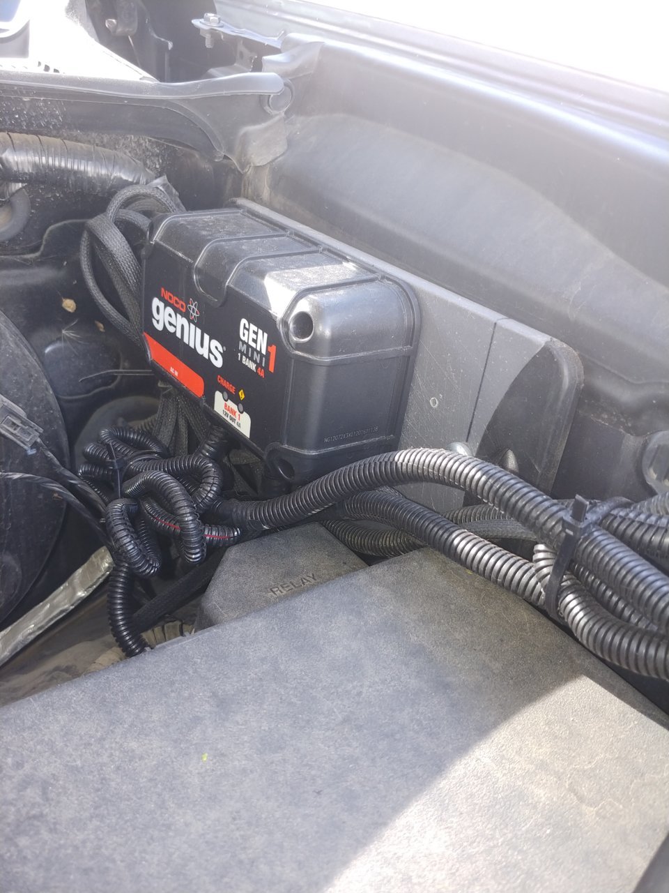

    Used those holes to mount the Noco Onboard Charger.

    Using mine for an Overland Equipped aux power bus as I begin adding goodies so I don't wind up with a rat's nest of wiring over time. Bus and light bar wiring harness went in last weekend, light bar goes in tomorrow.
