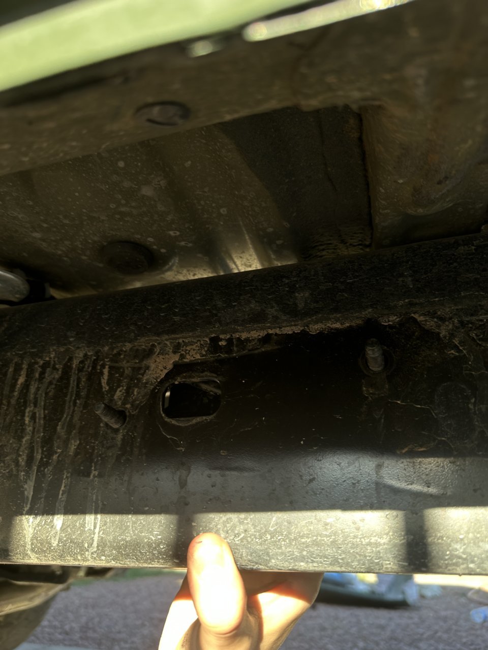

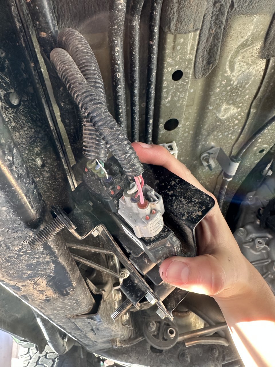

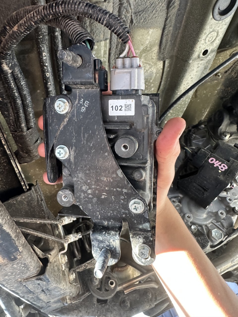

    I have the sensor that came off the frame of my truck on the undercarriage on the side of the driver. I don’t know what purpose it serves or what it’s for. I reconnected it, but I need to find the original way to hold it in place. Does anyone know whats its for and how it could of come loose?

    Hood Struts, My version Fogs always ON, Map & Overhead Light Mod,
    Fuel Pump Control ECU

    Holy crap! Looks like someone forgot to install the nuts! Are you the original owner? Did you have any work done where they were working on it? Inquiring minds want to know.

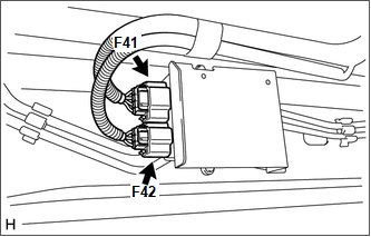

    If this is a used truck, someone may have temporarily removed the unit to uninstall some rock sliders. They probably didn't reinstall it properly.

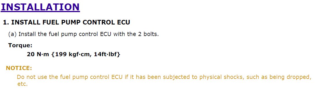

    Here is how it was originally installed and why someone may have messed with it.
