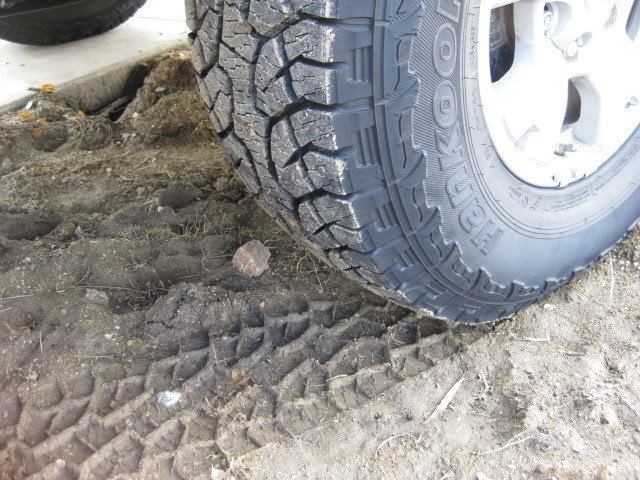

    I am sure happy with my Hankook Dynapro ATms (265/75-16, 1" taller than stock no rub)... 10,000 miles on them now.

    You won't be sorry! They work great in sand, mud, snow, and quiet on the highway... plus they look good, too!

    What about you gas mileage, did it drop or stay the same. Nice looking tire. Looking to get new tires can the 265 replace the stock 245?

    Dahm, they do look nice. Will keep them in mind for futur buy.
