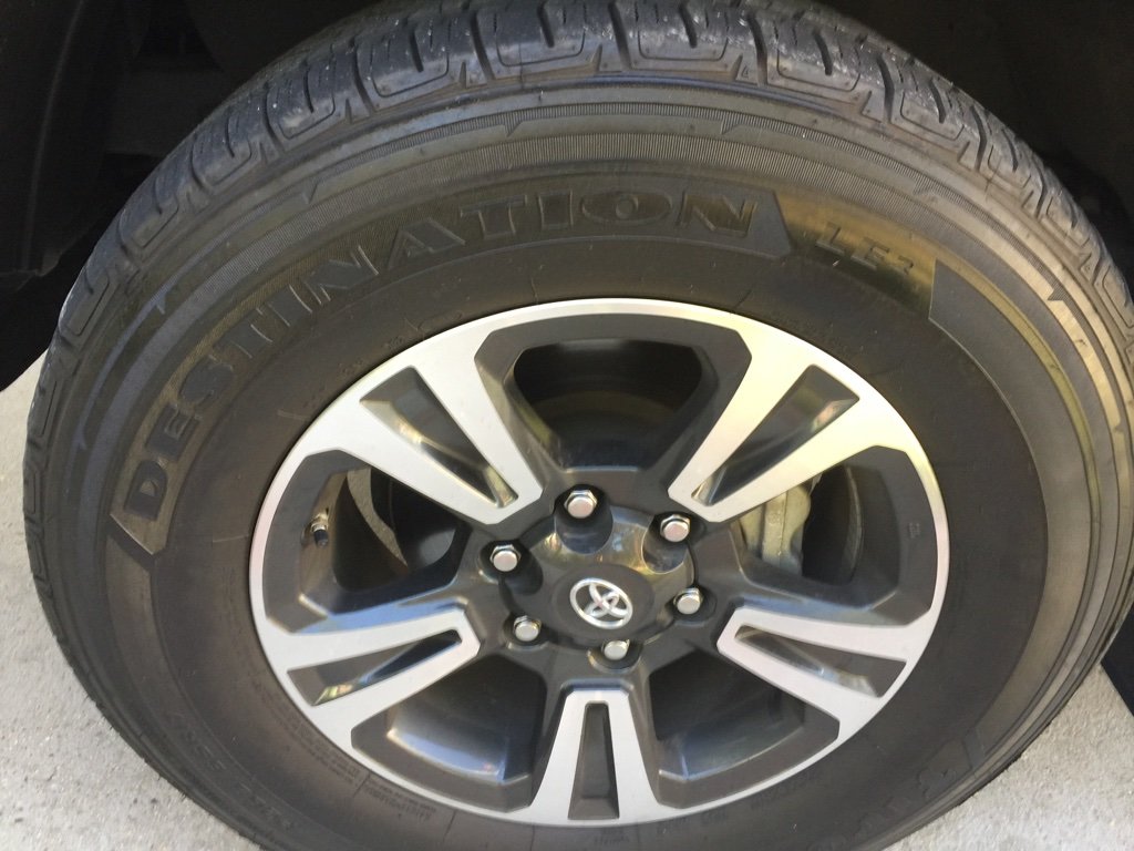

    my door says 29psi....2016 TRD Sport OEM Firestone Destination Te2 tires...what should i be running.....dealer keeps putting 35psi.....I asked why they dont put what is recommended.....was told the tech is “old school”....ummm

    That's funny. I thought the sports had Toyos? My door for the destination LE says 32 but i kept them at 35 which is what the dealer delivered them at. They seem to be wearing evenly over 6500 miles. I have a discoloration on one of my tires due to a gas spill so i know at least that they rotated that one to the front

    Not funny.....Here is what I have on the truck and what the panel shows...........mine was from Baha

    Yours being 17 inch and mine being 16 inch may alter what PSI they should be. I’d just stock with the OEM recommendation. And try to find a different dealer. They should work for you. Some seem to think its the other way around.
