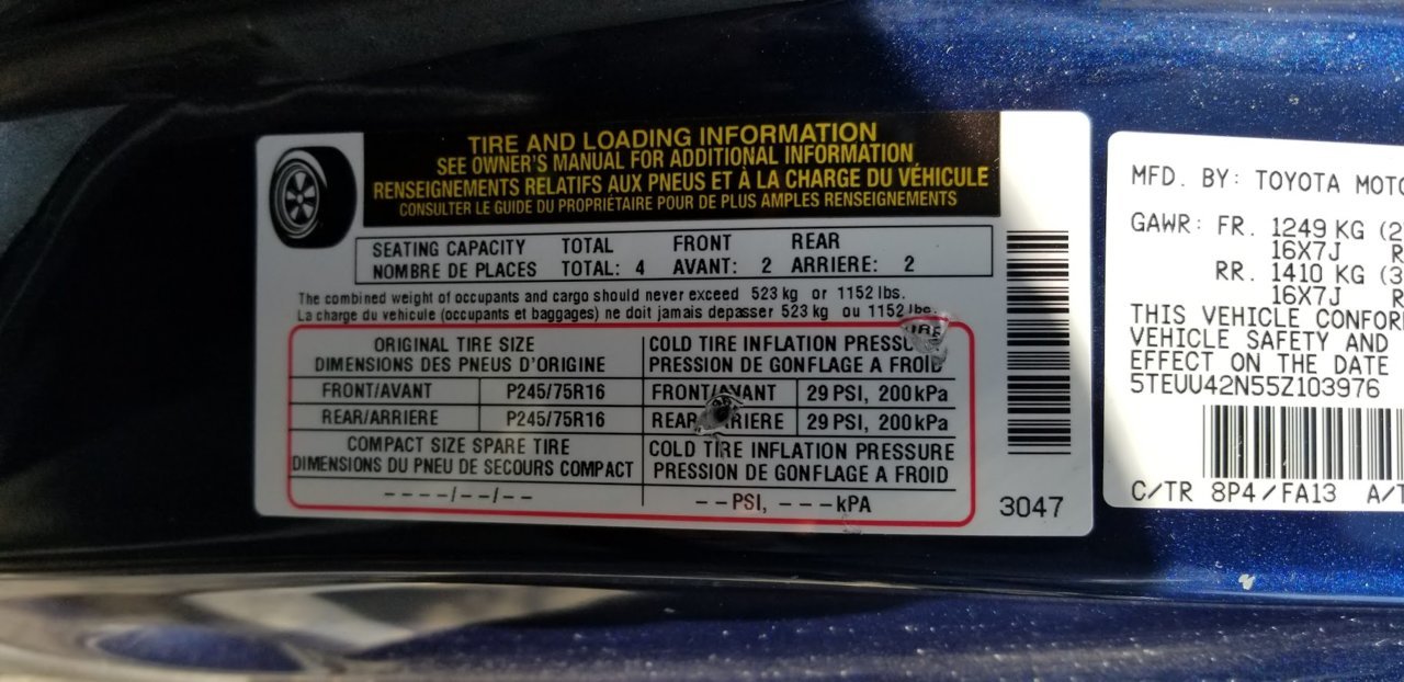

    2014 SR5
    door jam

    The door jamb lists the pressure for the stock tires, I have different type and size on

    door jam lists the PSI on the unloaded weight of the truck not the tire size

    It definitely has tire size and while not horribly clear, the grid make it looks like the PSI applies to that tire size
