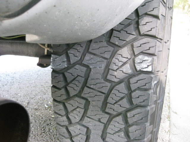

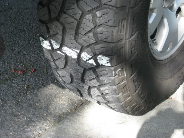

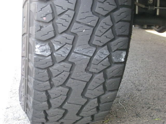

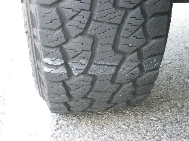

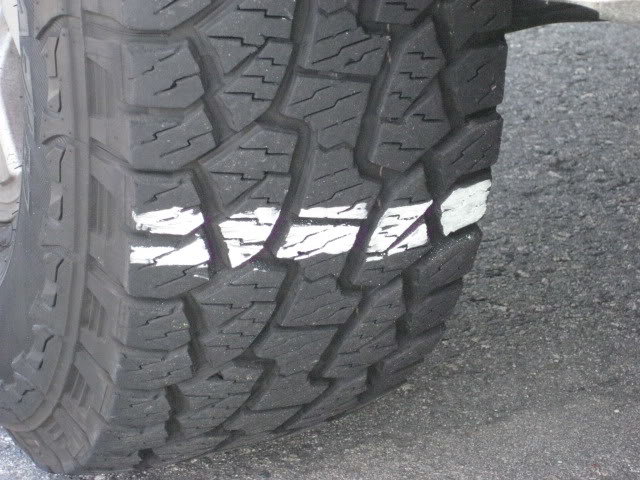

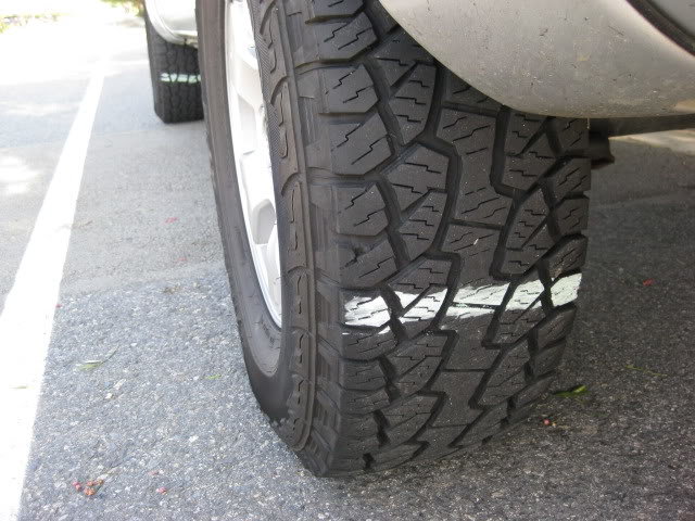

    Right Rear Before and After:
    Right Front Before and After:
    Left Front Before and After:
    Left Rear Before and After:
    There you go.... looks pretty even, yes? Maybe just a hair high? What do you think?
    FYI, these tires have 16,000 miles on them. Hankook Dynapro ATm 265/75-16.

    Yep, a tad high, but close. The biggest mistake people make with E tires is believing they need more pressure than any other tire. They don't. They just have a greater capacity. They run ridiculous pressures and then complain about the harsh ride. My truck is around 5,000lbs with weight front and back within 100lbs. I run 36 for daily driving, 40 on the highway. If I'm carrying a load I bump the back to 45. I won't run anything but E tires on my truck.
