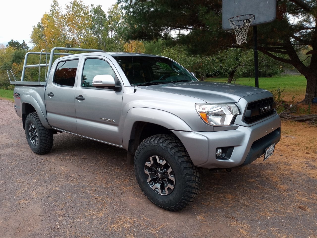

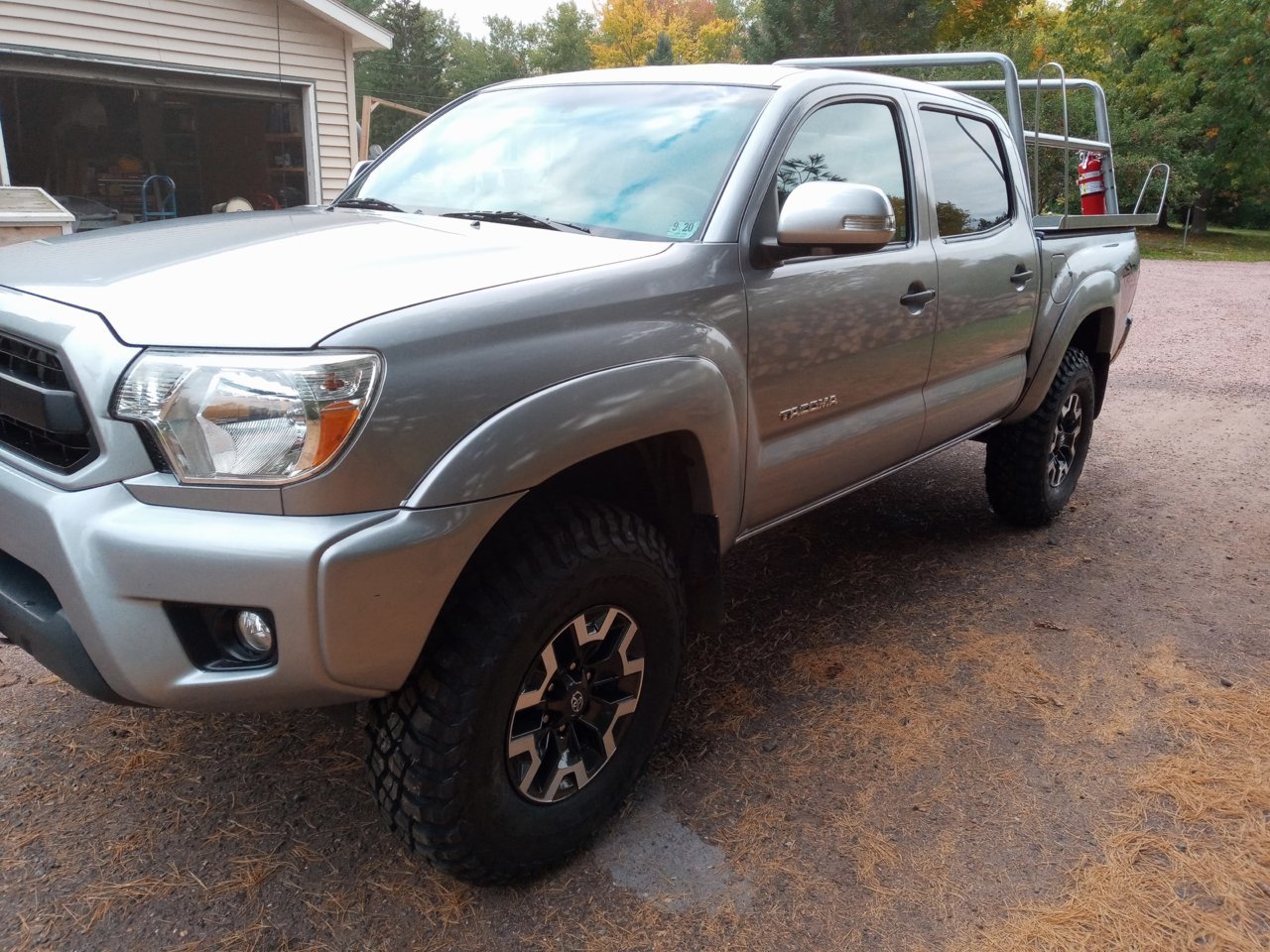

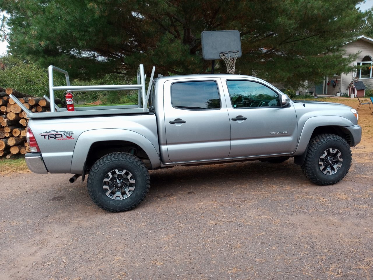

    I went with 255/85r16... BFG km3's. No noticeable performance difference... well maybe some MPG loss but not much given the bling factor. Noisy; but that just lets the deer know your coming. No rubbing on a 2 1/2 inch lift. Skinny 33 for the win...

    Here is as close to front as I currently have...
