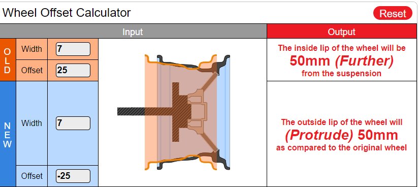

    I have a 2017 sr with stock tires and was wondering if a 265/70r17 with -25 offset wheels would fit.

    @Danec28 it will rub. The stock offset is +25 a -25 offset will poke more than 2 inches. A zero offset is ideal but the tire is taller than factory as well.
