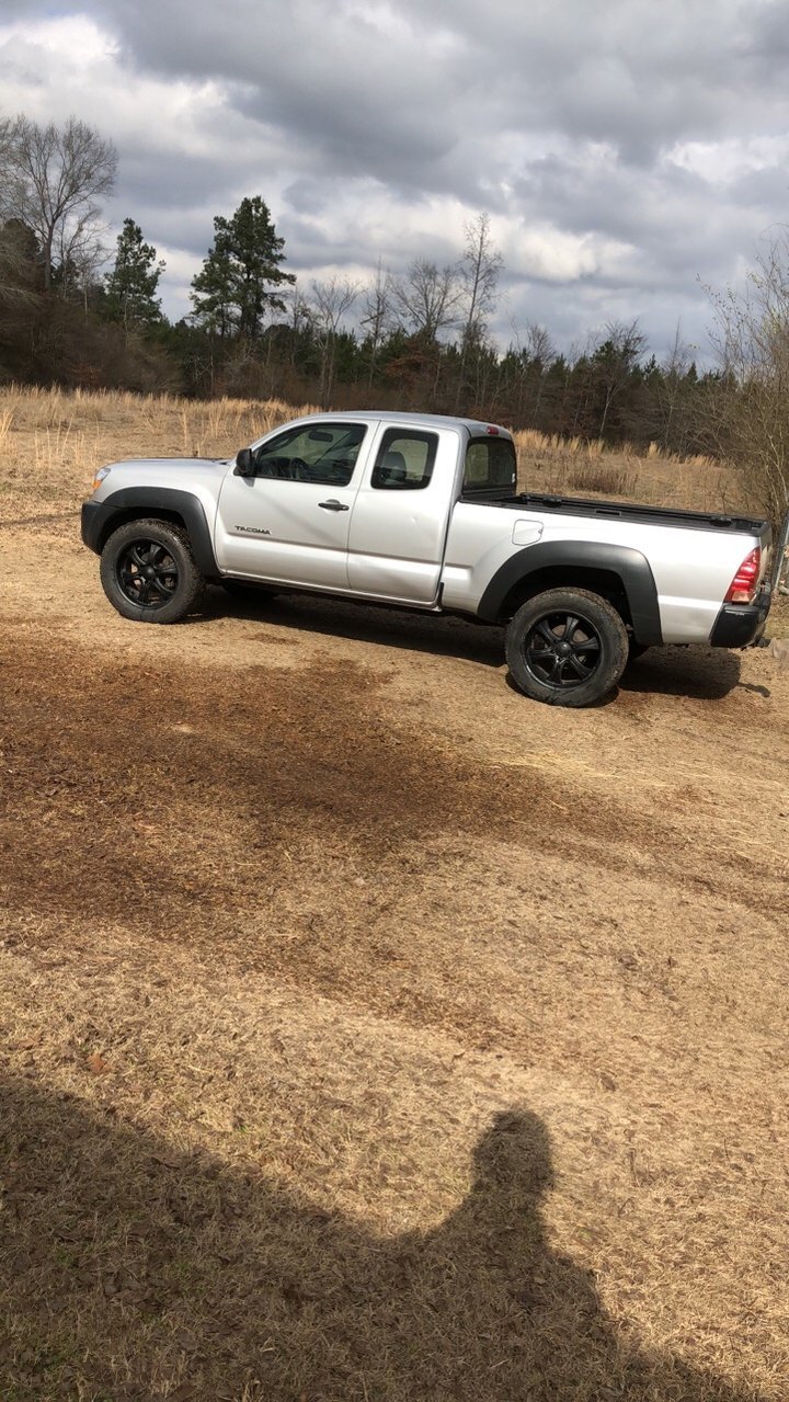

    I’m running 20s with 275/55/r20 tires. They rub a little when turning but I’ll solve that when I level out the front. 3F98F080-2CB7-4E5A-8364-B8F36C40143B.jpg
