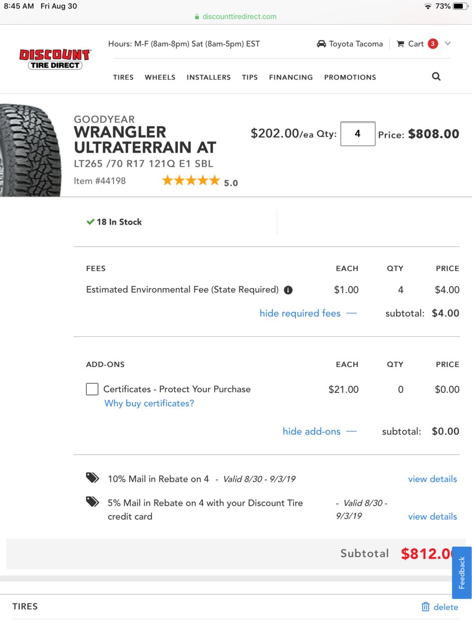

    My back up plan :anonymous:

    Hey Brother. Great choice. I looked at these when they came out but ultimately went with the Ridge Grappler (same size as you) on my 17' Sport.
