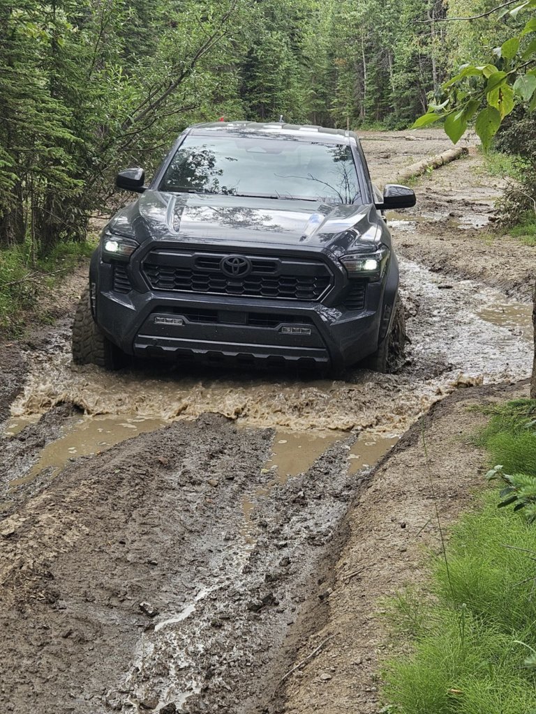

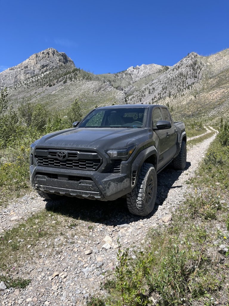

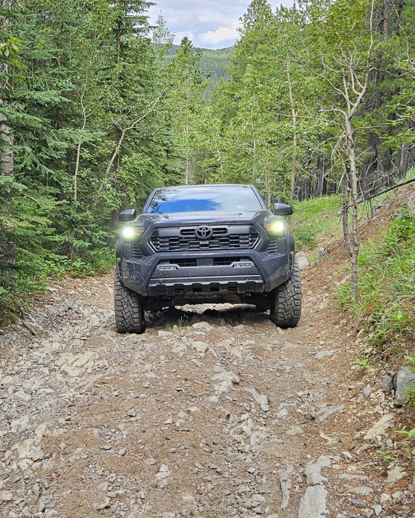

    I just thought I would update this thread I started from awhile back, thanks to everyone for their input. I went a different direction entirely with the wheels. I went with the Fast HD Recon 17x8 +20, mostly because it was one of the few available with the new 95.1 hub bore. For tires I went with the Toyo R/T in E load 285/70R17. Very happy so far, it has just walked through everything I have put it up against to this point.
    Everything is fitting great on stock suspension, but I’m craving a small lift and toying with the idea of going 295/70R17 as there is a new set of Toyo R/Ts on marketplace near me, or maybe a C load Toyo MT in 285/70R17.
