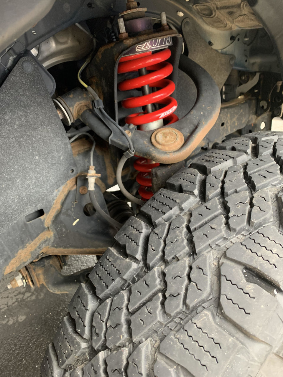

    After researching I think I'm gonna lightly sand down the frame and then hit it with black Woolwax. Anyone have any experience with the black woolwax?
