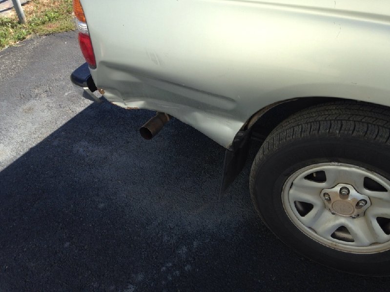

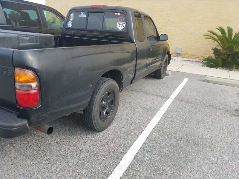

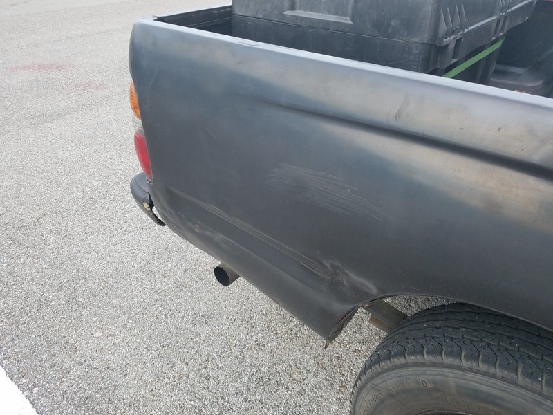

    As you can see, it's a pretty nasty dent, creases and everything.
    It was like that when I got the truck, which is the main reason why it was so cheap.
    I've looked into fiberglass fenders, replacing the whole damn bed with one from a junk yard, to taking it to a body shop and seeing what they can do about pulling out what they can and going nuts with Bondo...
    Any thoughts/ideas?
    I don't mind spending money, as long as it's actually worth it.
    I do have an aluminum ultility topper on it now, not sure that fiberglass fenders can support it.
    Thanks

    Do nothing and just roll with it. Or sand the rusted spots, prime and paint those and leave the dent.

    Fiberglass fenders are meant for lt and would look silly if you didn't add any width.
    Get under truck with junk of wood and bfh and beat it out the best you can and see how happy you are with it.
    Quickest easiest option with the least amount of downtime would be to just get a whole "new" bed.

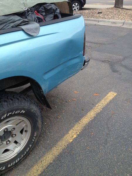

    This costed 2,000 bucks to fix, if you wanted any insight.

    Pulling then bondo is probably best bet. Beds in dallas fort worth are around, costs hover around 500.
    Have a shop give hou a quote, then compare to what a bed would cost. I really dont like body damage either, i feel your itch to get it fixed.

    Leave the battle scars. Do something to treat the rust and prevent it from getting worse. Spend very little and let your truck keep it's utilitarian attitude.

    You can buy a complete bedside for around $400 bucks. They are surprisingly easy to change as long as you a have a spot weld cutter and a welder to tack weld the new side on.

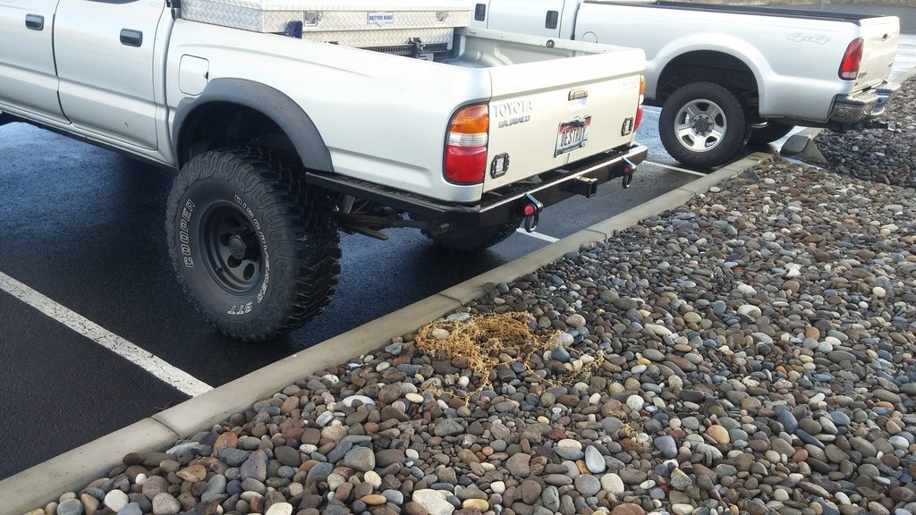

    i made this one, something like it and you could get rid of most of your dent

    If you have a paintless dent removal professional in your area, they can remove that for about 400-600. It will look great in the end too with out using anything that will damage the paint. If you're in the Bay Area, I can give some names.

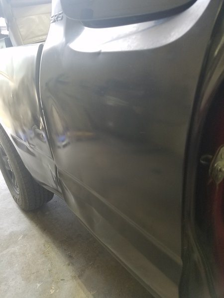

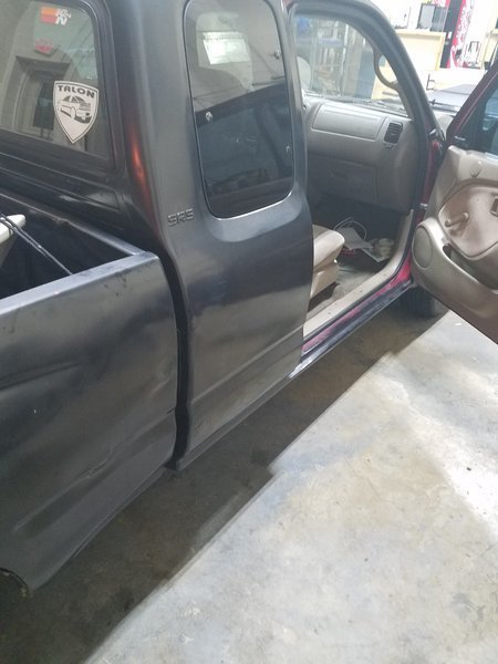

    Before and after here. Sorry I cant find a before and after of the huge rear dent.

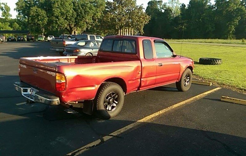

    Red is before and the only good before pic I could find. Just grabbed the two others. It's not perfect but it's a hell of a lot better than it was.
