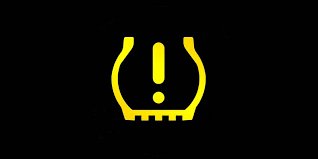

    If it does you should have a TPMS light that comes on for a sec when the key is turned on.

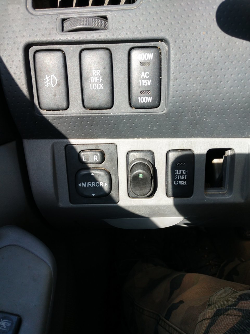

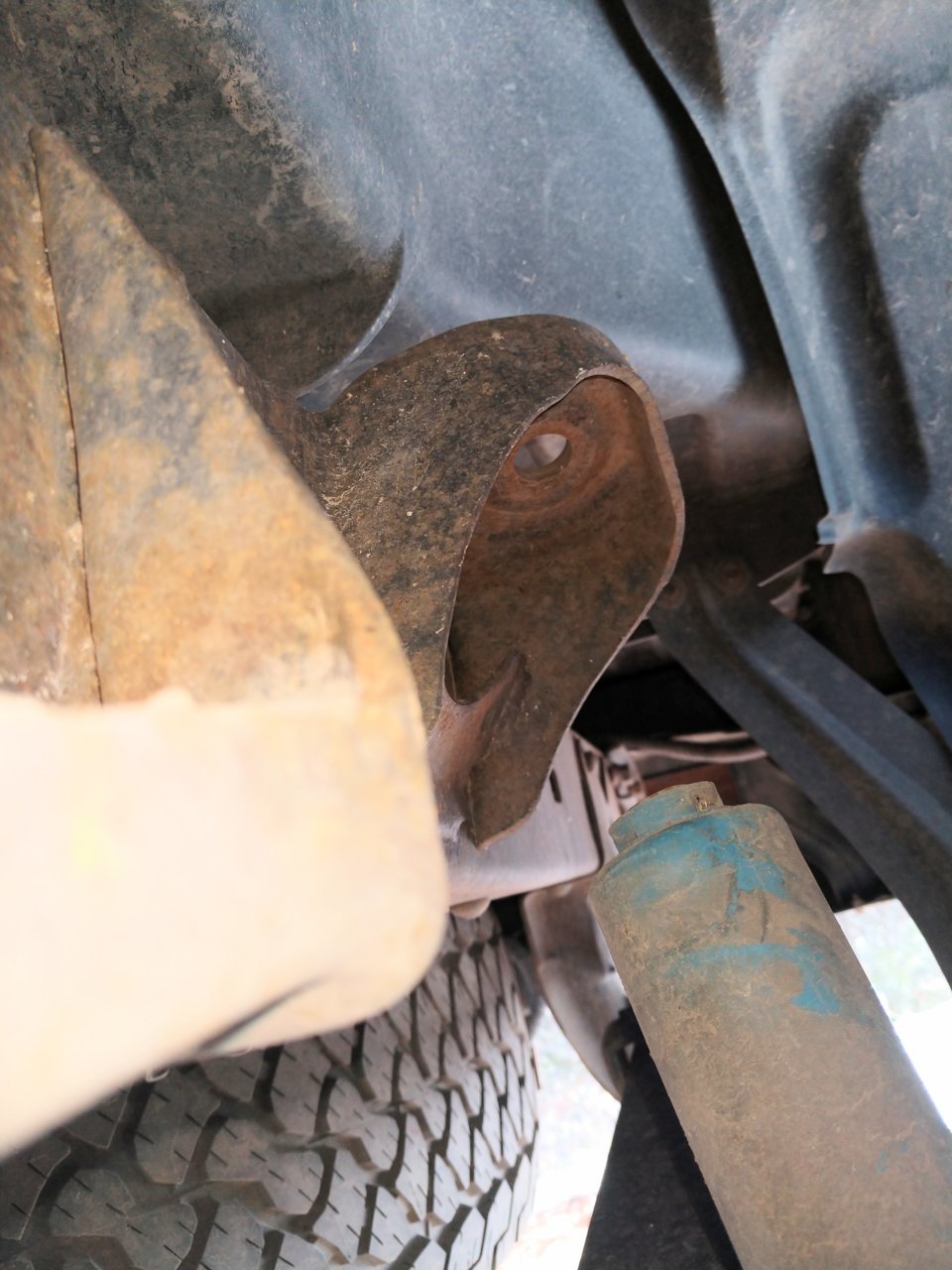

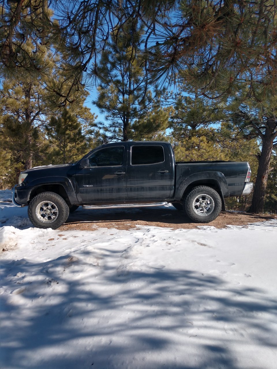

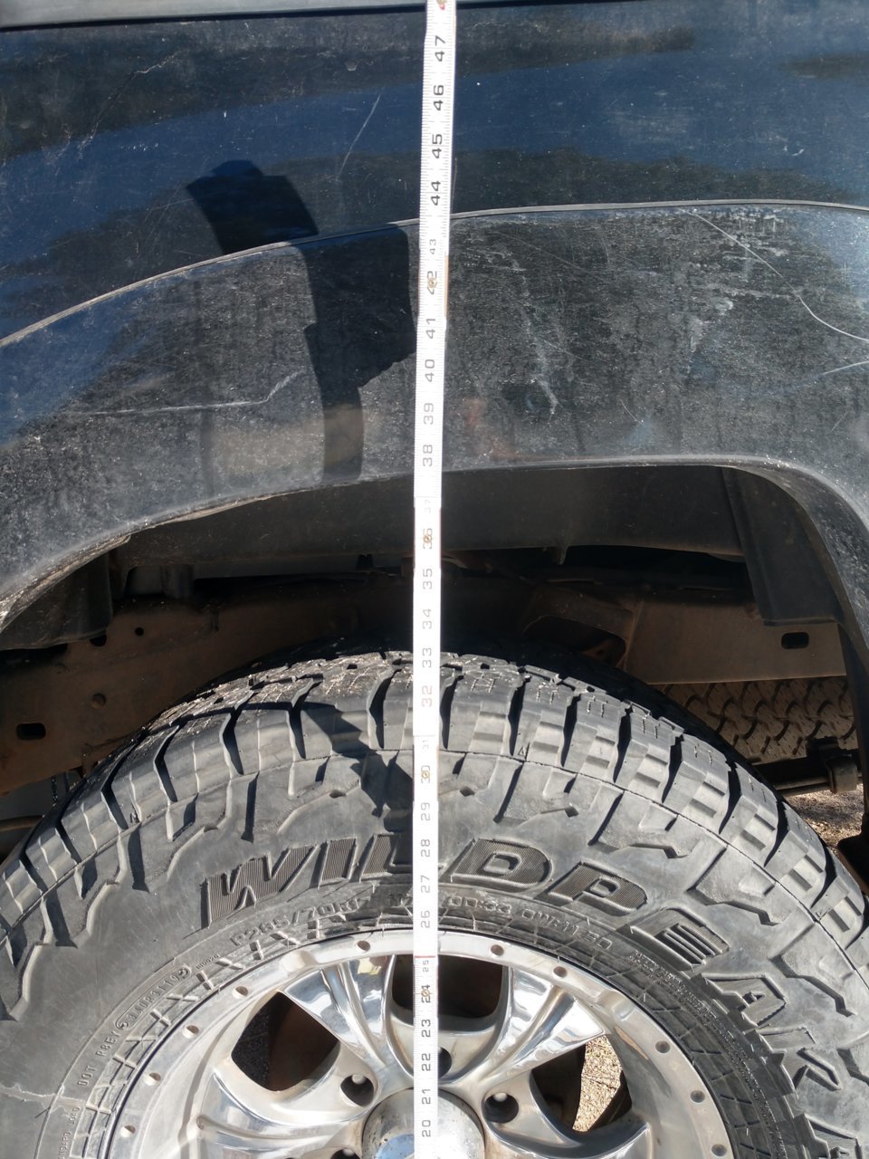

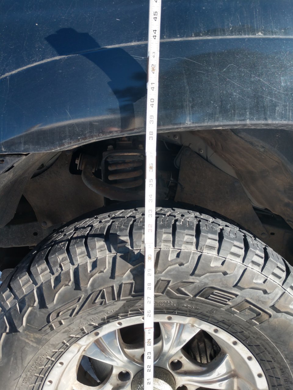

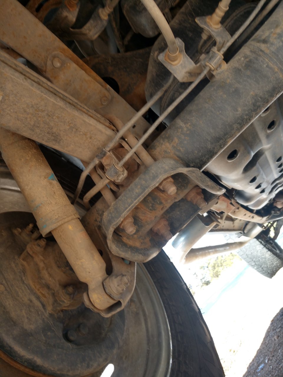

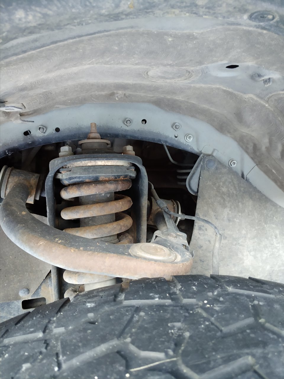

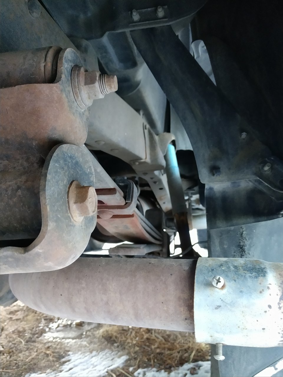

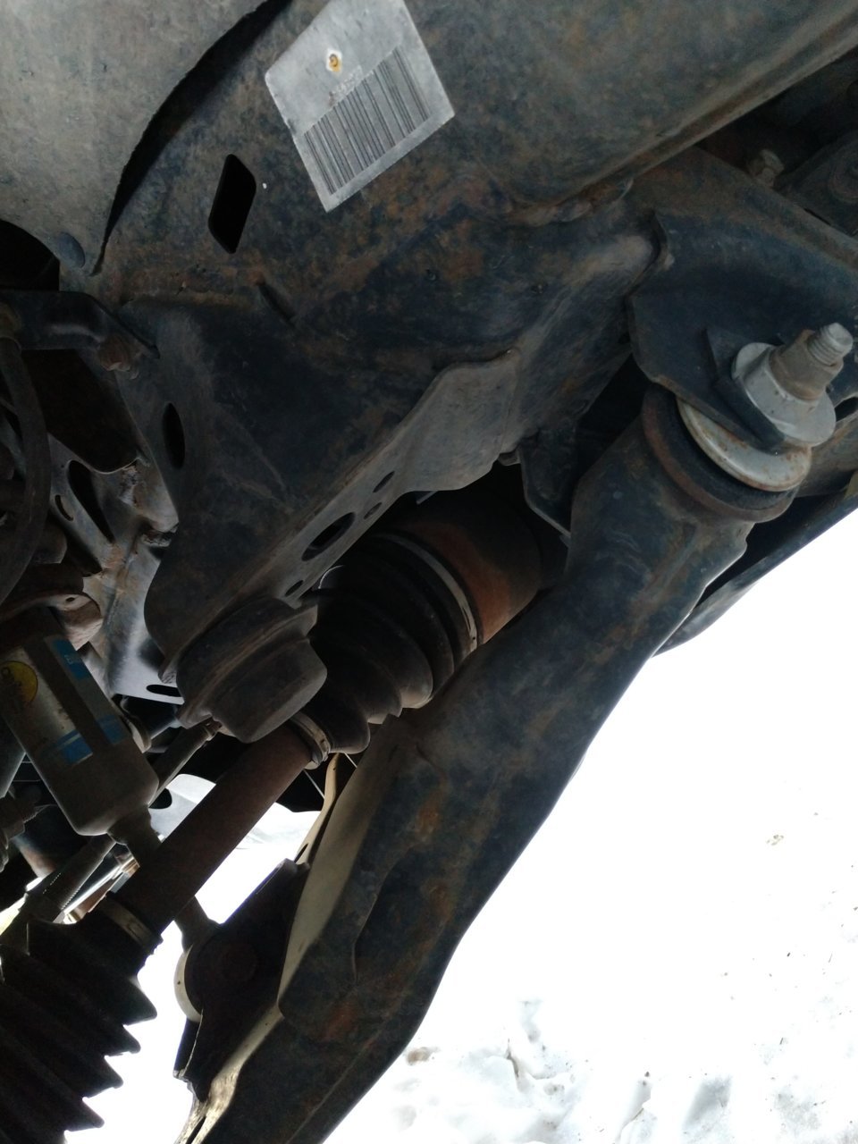

    IMG_20220205_105244164_HDR.jpg IMG_20220205_110526233_HDR.jpg IMG_20220206_171452282.jpg IMG_20220206_171534785.jpg IMG_20220206_171550529.jpg Thanks for all the replies. I've attached some pictures of the dashboard buttons, not sure what the switch is between the mirror and clutch start button? Also included some pictures of the rear and front suspension as suggested so others can weigh in. Rear differential has a sticker on it not sure if it means anything. Also found the drivers side top of rear shock is broken. Can I replace with original OEM shocks even though it's been lifted.
    Again thanks again

    Not sure, it's aftermarket so you would have to trace the wires and track that down yourself, does it have any aftermarket lights that you see?

    Need to see the front of the rear diff but having the button is a good sign.

    Cant tell from the pics if the truck has a rear lift. The front looks stock unless it has aftermarket coils. Measure the height from ground to bottom of the fender through center of the wheel and post the results. Someone here can measure similar setup to compare heights. I have a 2.75” lift; my height is 36 inches with 17-inch wheels.
    On rear need a clear pic where the leaf springs mount to the axle. I dont recall height in rear on my truck with an inch lift.

    Frame looks good. I spoke with previous owner and he said extra dash switch is for roof light bar. He also said he bought the truck already lifted and he thought the previous owner said it had a 3 inch lift. I've included some pictures of the fender heights appears the front is approximately 38 and the rear is 37 1/2. The tires are 285/70/17. IMG_20220208_104943051_HDR.jpg IMG_20220208_105028559_HDR.jpg IMG_20220208_104943051_HDR.jpg IMG_20220208_105028559_HDR.jpg IMG_20220208_105118267_HDR.jpg IMG_20220208_105154919_HDR.jpg IMG_20220208_105201902_HDR.jpg IMG_20220208_105333993.jpg IMG_20220208_105422340_HDR.jpg I've also included pictures of the front of the rear differential and a few of the rear suspension including the top of the broken shock... thanks

    Can't tell for sure but looks like you have a small spacer lift in front with Bilstein 5100 shocks. Can't tell if the 5100 spring perches are set for lift or not, you would need to look at the bottom of the front spring perch and count how many grooves up it's mounted.
    Rear looks like Bilstein OEM or 4600 shocks (basically same same). Junk, replace. Leaf springs it's hard to tell what's going on there or what they are. There was a TSB spring replacement that switched them to 3+1 like this but I'm not sure, kinda looks like an add-a-leaf.
    For the fender measurements, go from the center of the wheel hub to the fender. Stock front is like 20.5" and stock rear is like 22" if I remember correctly.

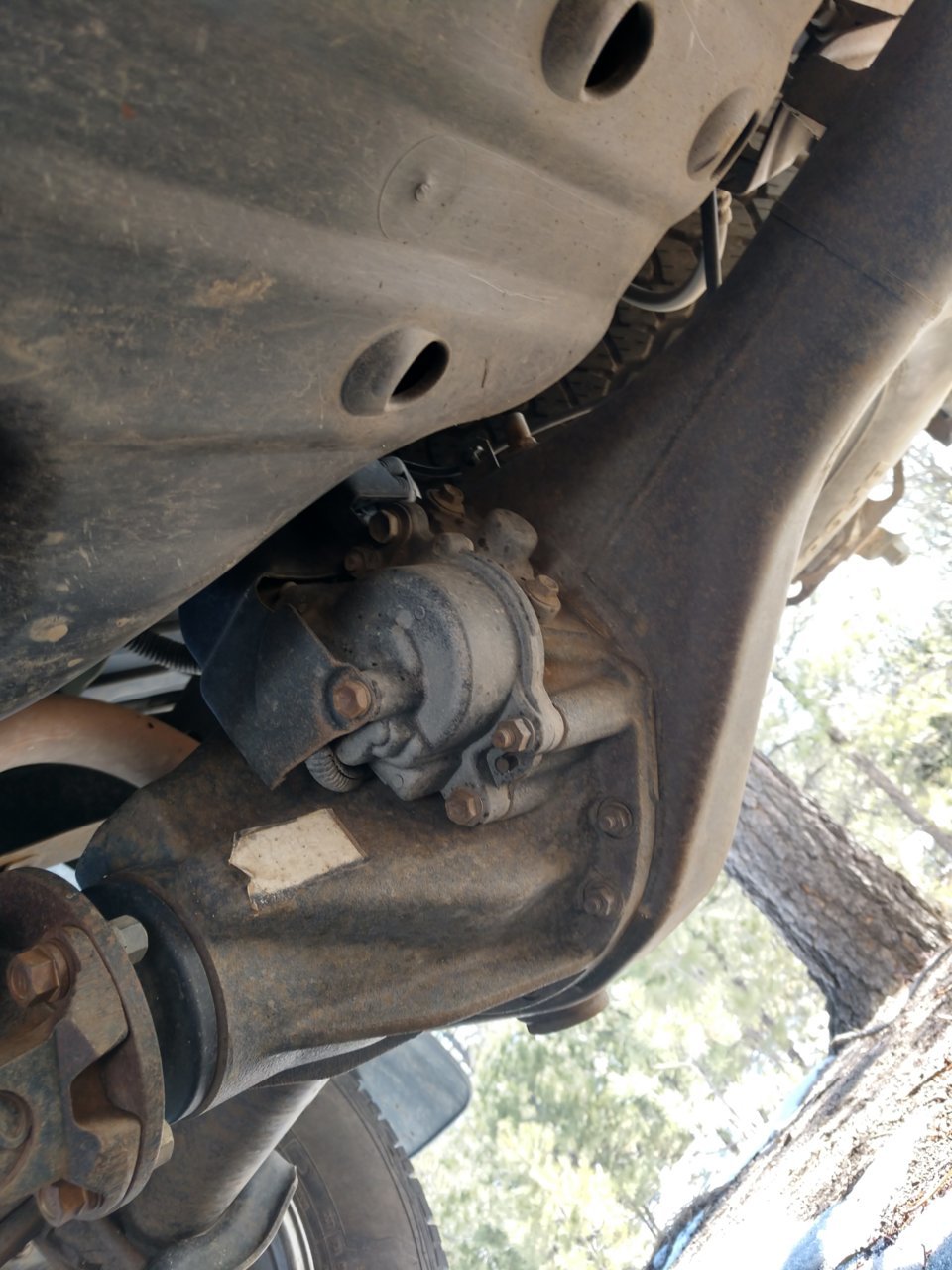

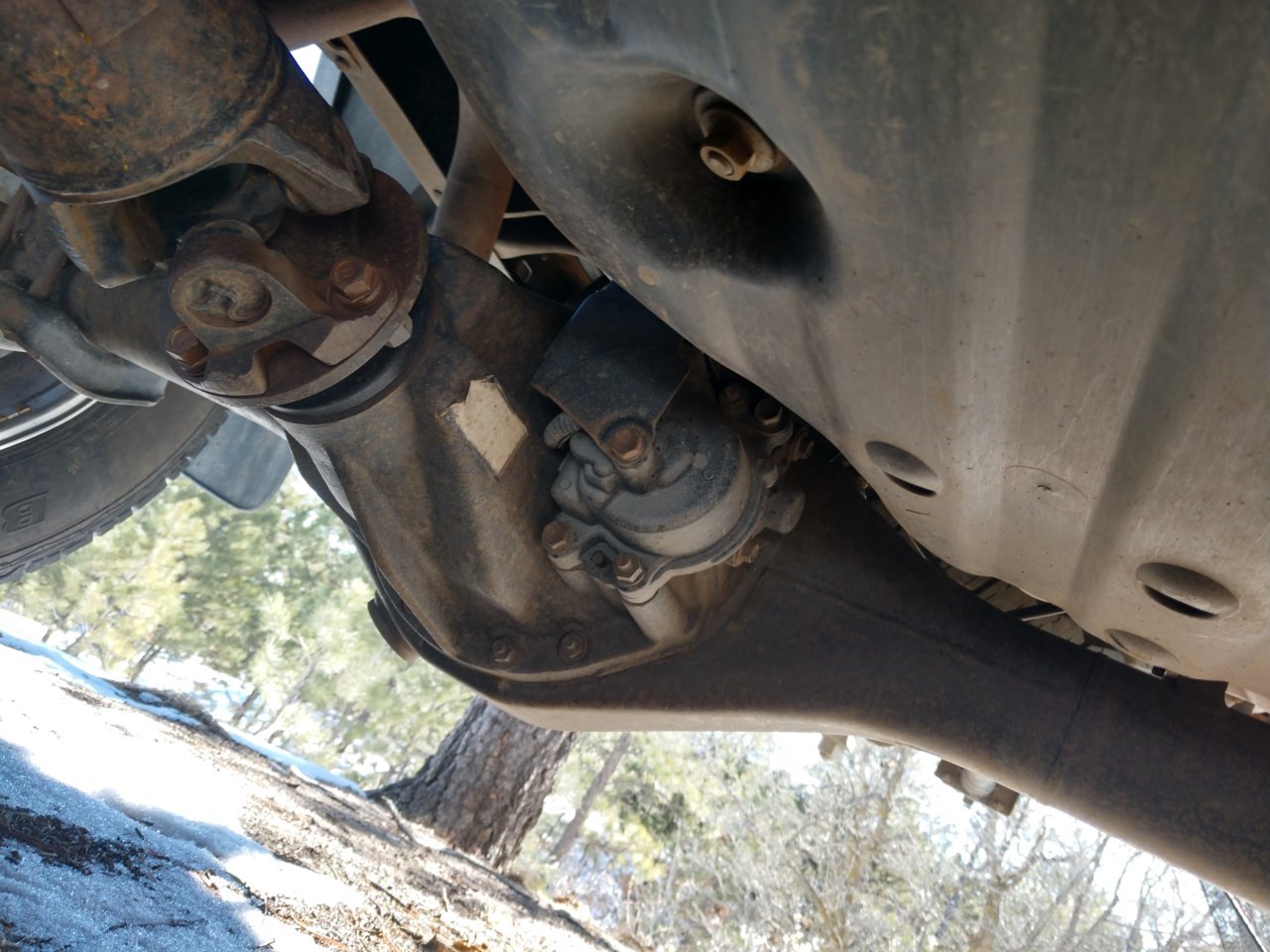

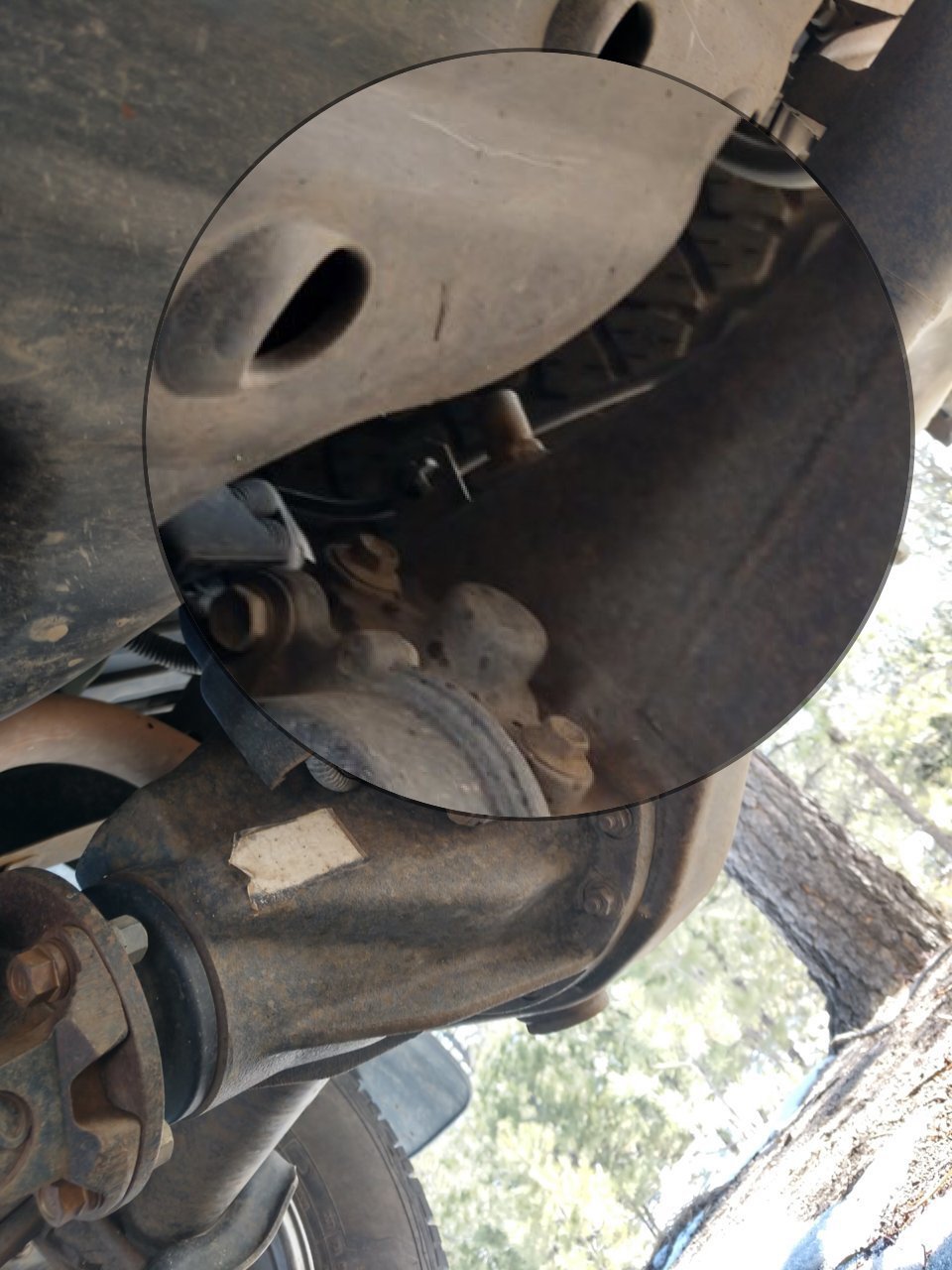

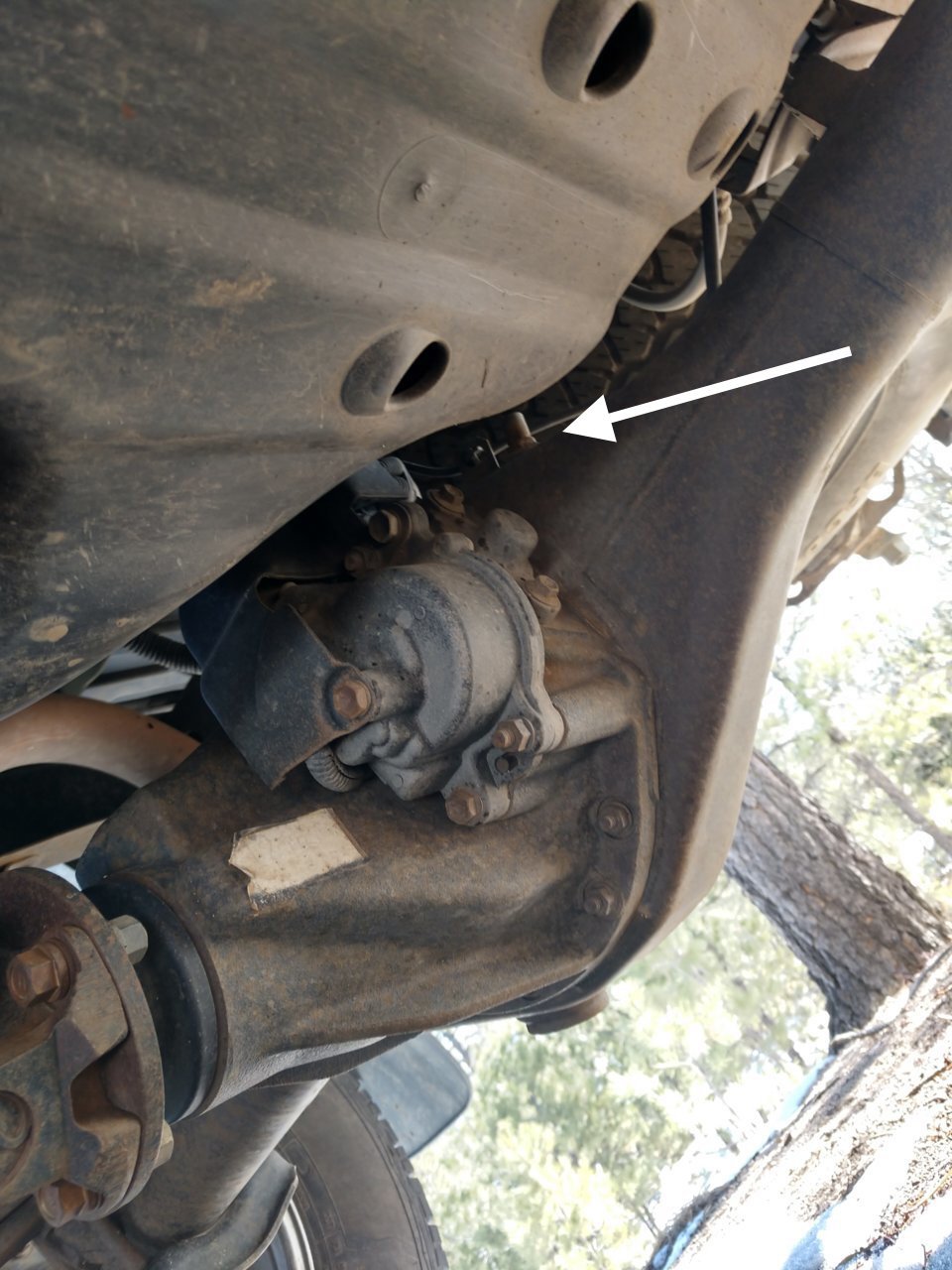

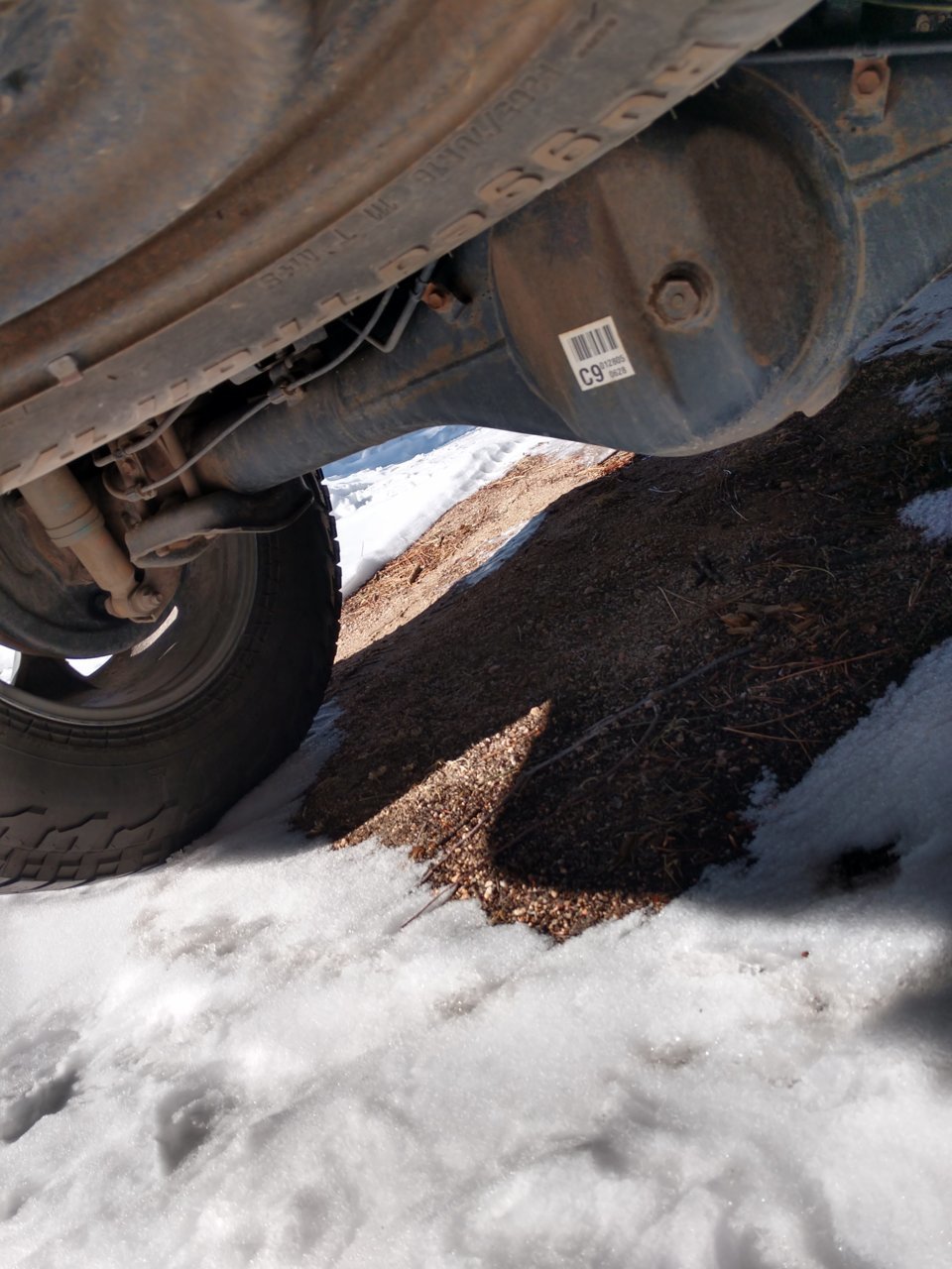

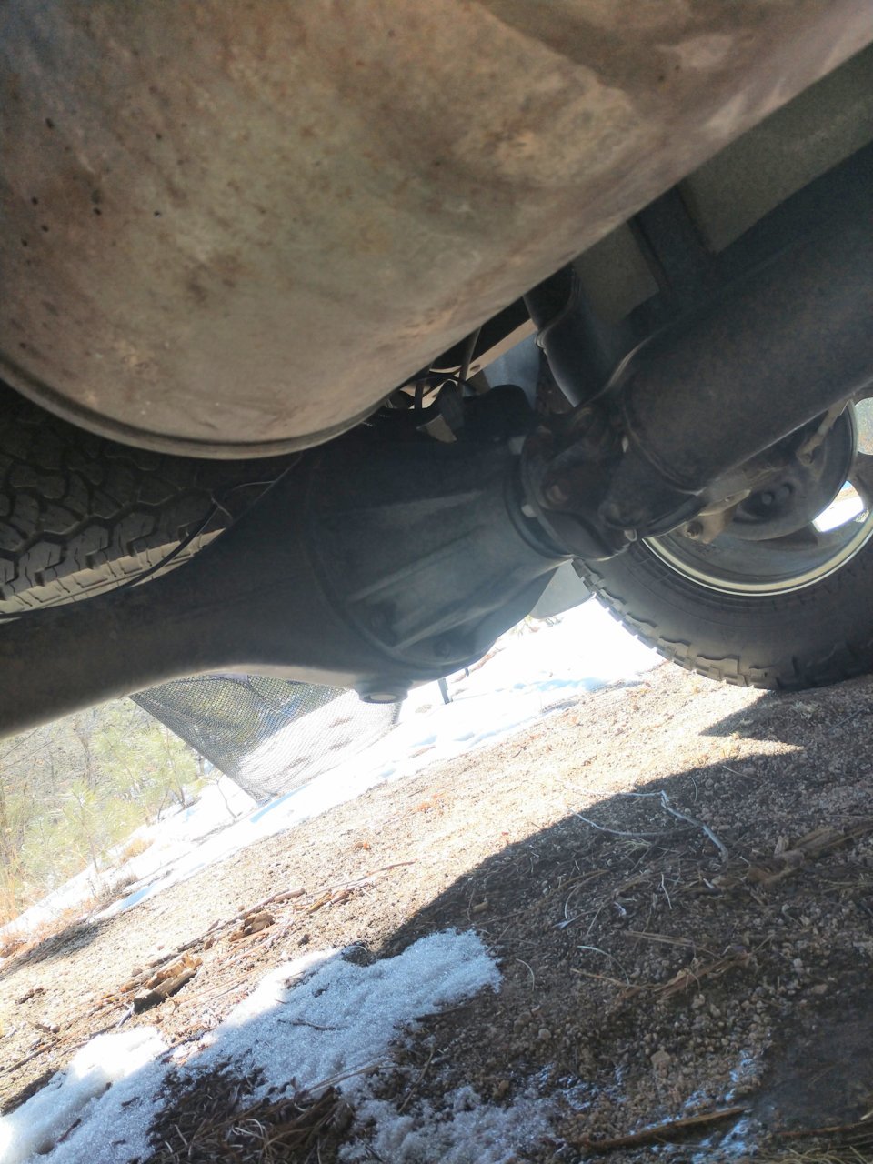

    Hey key-rei.... wondering if these pics of the front of the rear differential tell you anything about the limited slip...thanksIMG_20220208_105201902_HDR.jpg IMG_20220208_105237039.jpg

    That is the e-locker diff, no limited slip.

    While you are changing the rear Diff fluid, you might consider changing the vent too.
    If it get stuck shut, it will vent out through the axle seal. Usually on the drivers side in my case.
    Pulling the axle is no fun. It’s a lot easier to pay like 15$ for a new vent.

    That's a TRD Off-Road OE E-Locker. :thumbsup:

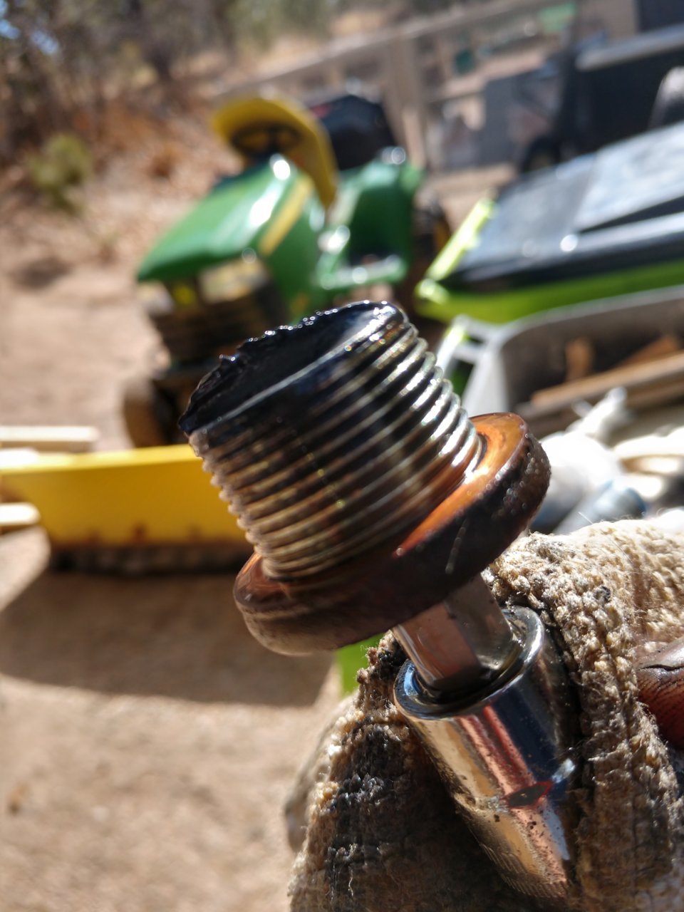

    Hey... just wanted to say thanks and provide an update and share what I have done and what I found. I took advantage of the warm weather here in Colorado and installed sparkplugs, PVC valve, cleaned maf sensor and throttle body, changed oil, transfer case, front and rear differential fluid, rear diff vent, and greased the drive shafts.

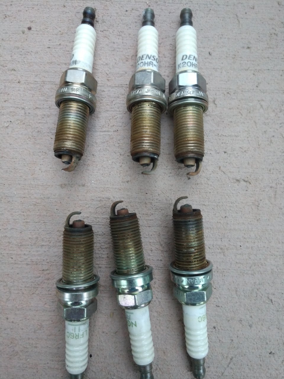

    I thought I would share pictures of the sparkplugs as I've never seen plugs this worn down. As you can see the electrodes are worn down into the sparkplug body. Just for fun i measured the gap and it was .090 or more than twice the suggested gap. I'm wondering if they have ever been changed since there's 3 ngk and 3 denso which is how they came from the factory. It has 203,000 miles on it. I bought the truck a few weeks ago and drove it 60 miles home and probably another 30 around town and it actually ran ok. Of course now it runs great in comparison.... thanks again.

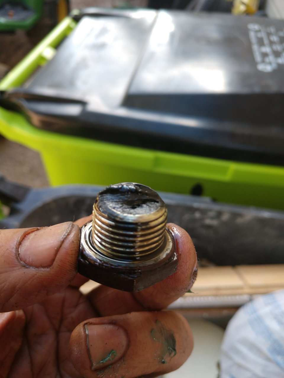

    I also have attached pictures of the rear and front diff magnetic drain plugs showing the amount of metal shavings on both. I would estimate the thickness at 3/16 of an inch. I have know idea if the duff fluids have ever been changed.
    Again thanks for all the guidance and suggestions
