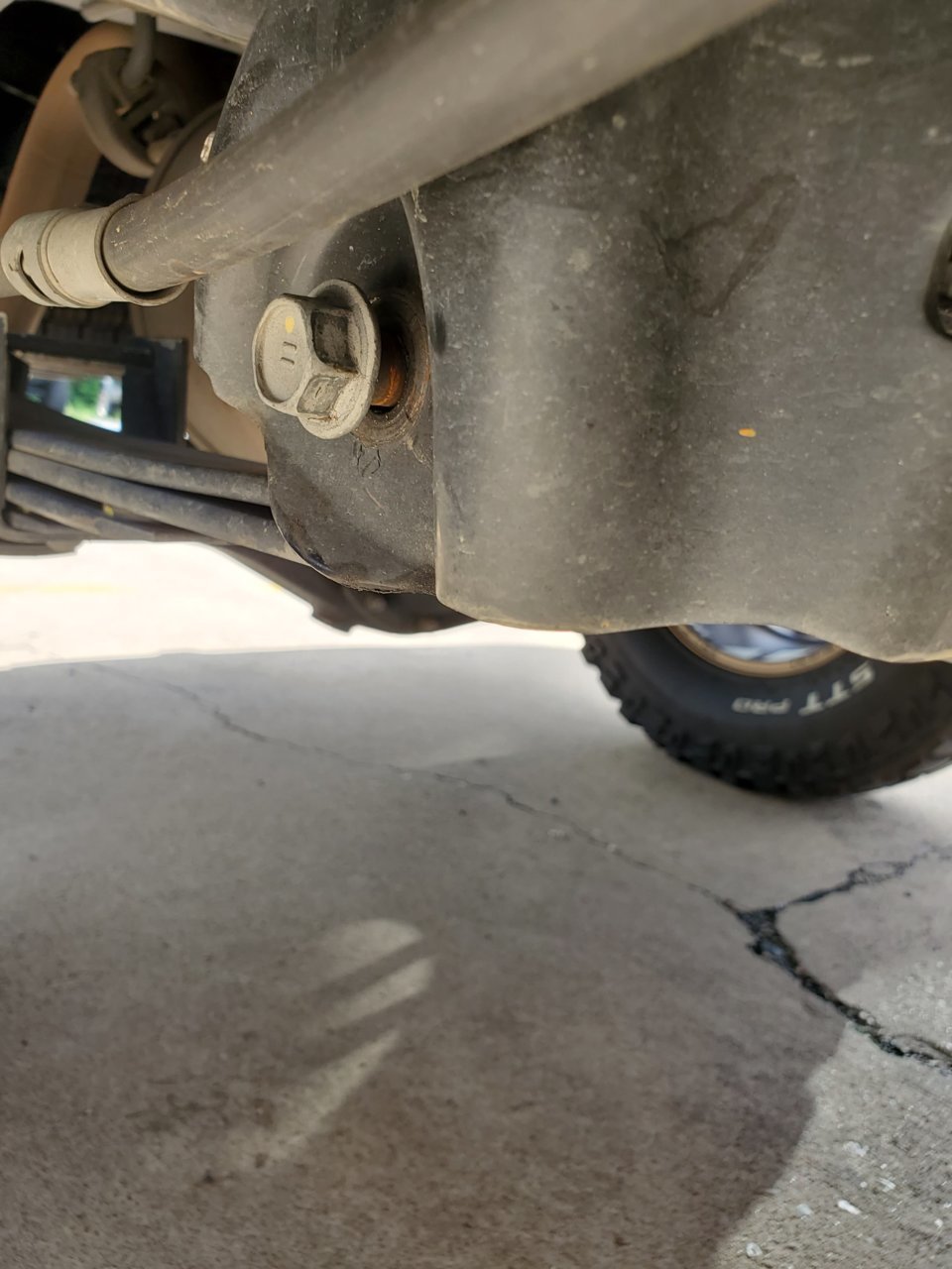

    I just finished a trip to flagpole this weekend and noticed some squeaking at what sounds like my back left leaf springs. I had the same squeaking when I initially put my lift on and it ended up being a lose bolt. What else should i look for if it doesn't end up being a lose bolt that's causing the squeaking?

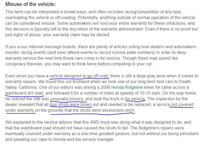

    Don't take your truck to the dealer after a trail ride. If they see dirt, they deny warranties. Not so fun fact.

    im not too mechanically incline, but it was this bolt at the end of the leaf spring
    Skydvrr[QUOTED] likes this.

    Gawt damn! That's an important one haha.

    yeahhhhh, the guy that found it said i was living the final destination life LOL. but i now know the importance of retorquing lol

    :eek: That's not supposed to be like that.

    i doubt it would come all the way out

    him: *takes a TRD Off-Road off-roading*
    dealer: "there goes the warranty, shouldn't of misused the truck"

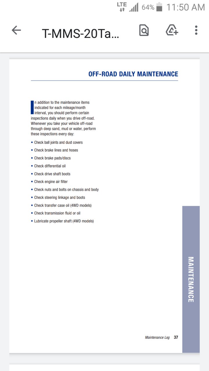

    #32761
    7,858
    NW Arkansas
    2016 TRD OFFROAD DCSB MGM
  20. Oct 30, 2020 at 10:53 AM

    That bolt looks a bit rusty ... now I’m going to check all my bolts lol
