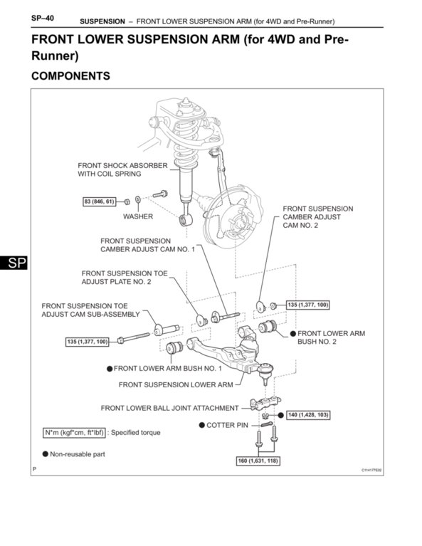

    Anyone have a page from the manual that shows the LCA and cam bolt assemblies? Thanks in advance:thumbsup:

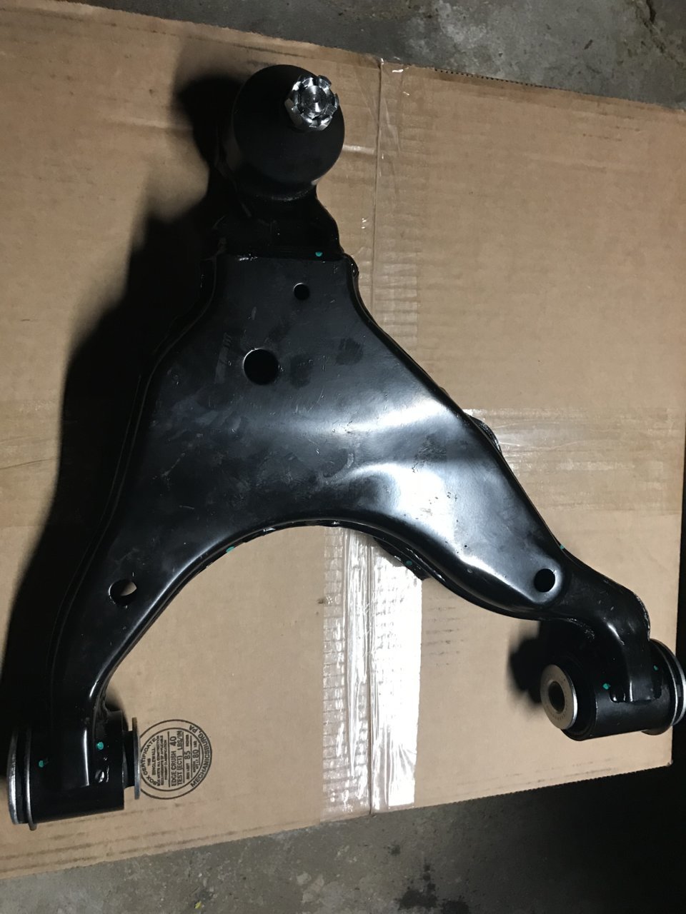

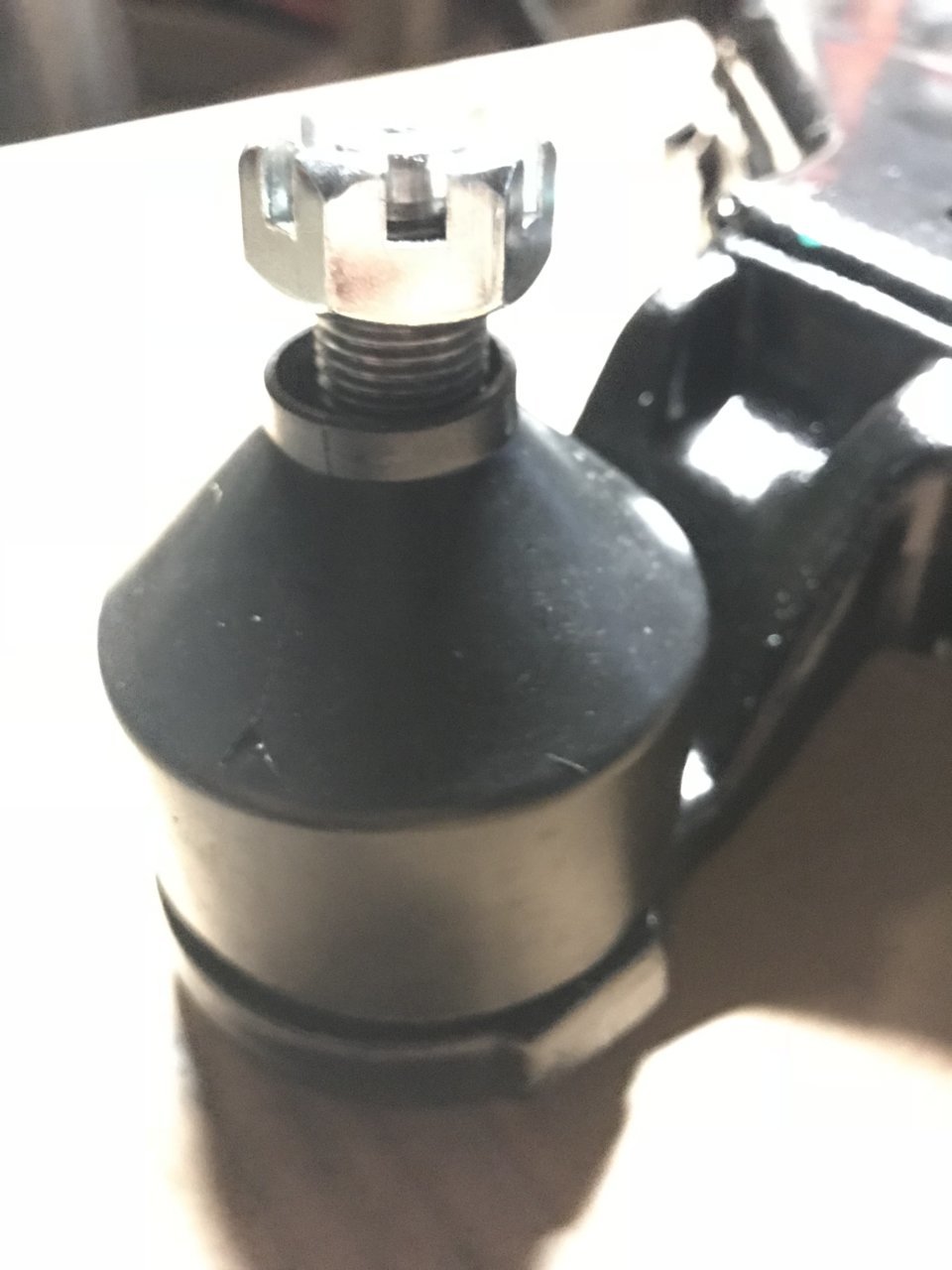

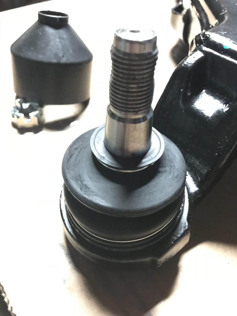

    Got some from eBay the other day after learning mine were seized and I couldn't get the total Chaos cam tab gussets done. They were $128 shipped to my door and are of surprisingly great quality:
    B6060F5F-DABF-4862-8EFE-322490A2B4A3.jpg 50DE6C2B-D089-4A93-9A51-A027D4A2CADC.jpg 46A35147-C8FF-4905-BF56-EEC87AB927EB.jpg
