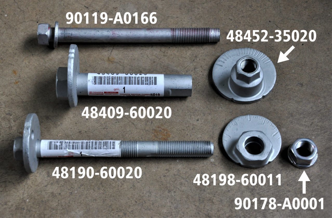

  9. Jun 7, 2019 at 4:48 AM
    #69
    birry
    birry Well-Known Member
    Oct 5, 2012
    #88370
    630
    Oklahoma City, OK
    2008 4x4 DCSB
    OME 885, Bilstein 5100's, Wheeler's (single) AAL
    I just ordered two sets of what's in that photo to have on hand for whatever I have to destroy in the process of getting mine back in working order. It is not cheap, but hopefully I can re-use some of my current hardware. I also went with the Toyota bushings and just plan to put some anti seize or grease on the bolts/sleeves, and see how that works. Fingers crossed!
    BillsSR5 likes this.
