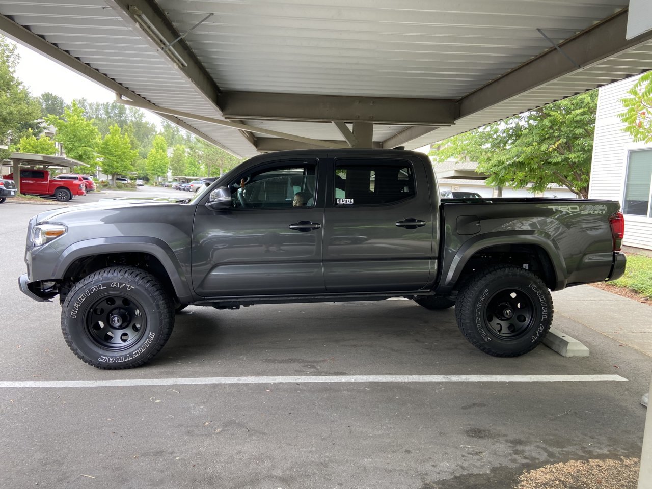

    So I’m assuming or hoping that the coils have finally settled but not the way I wanted it to be. I don’t know what the OEM measurements on stock height but right now from center of the wheel to fender it measures
    (front) 21.5”
    (Rear) 23.75”
    I do have a 2” block in the rear but I want the truck to be level. I don’t want to take apart the setup and Re do it so is it worth to take the 2” block off or add a 1/2 spacer?
    Thank you! I’m still learning.

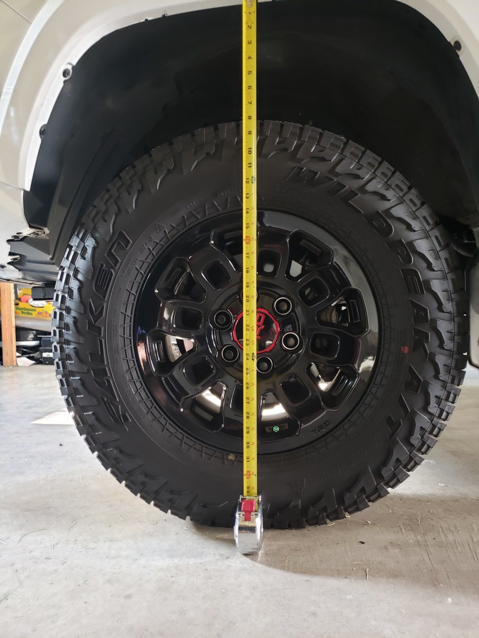

    I’m on top setting with my long bed. Talked to Bilstein direct. Said it’s fine. Ride is stiffer than stock but Imo I’m good with it. No nose dive body roll. Feel planted. Also no sag. Ground to fender 37 5/8” fronts. Rear aal about 1” -1.25” rake. I say run oem coils. Bilstein also said 5100’s are meant for stock coils.

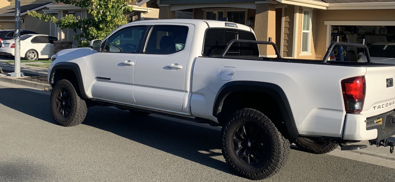

    Pick for reference

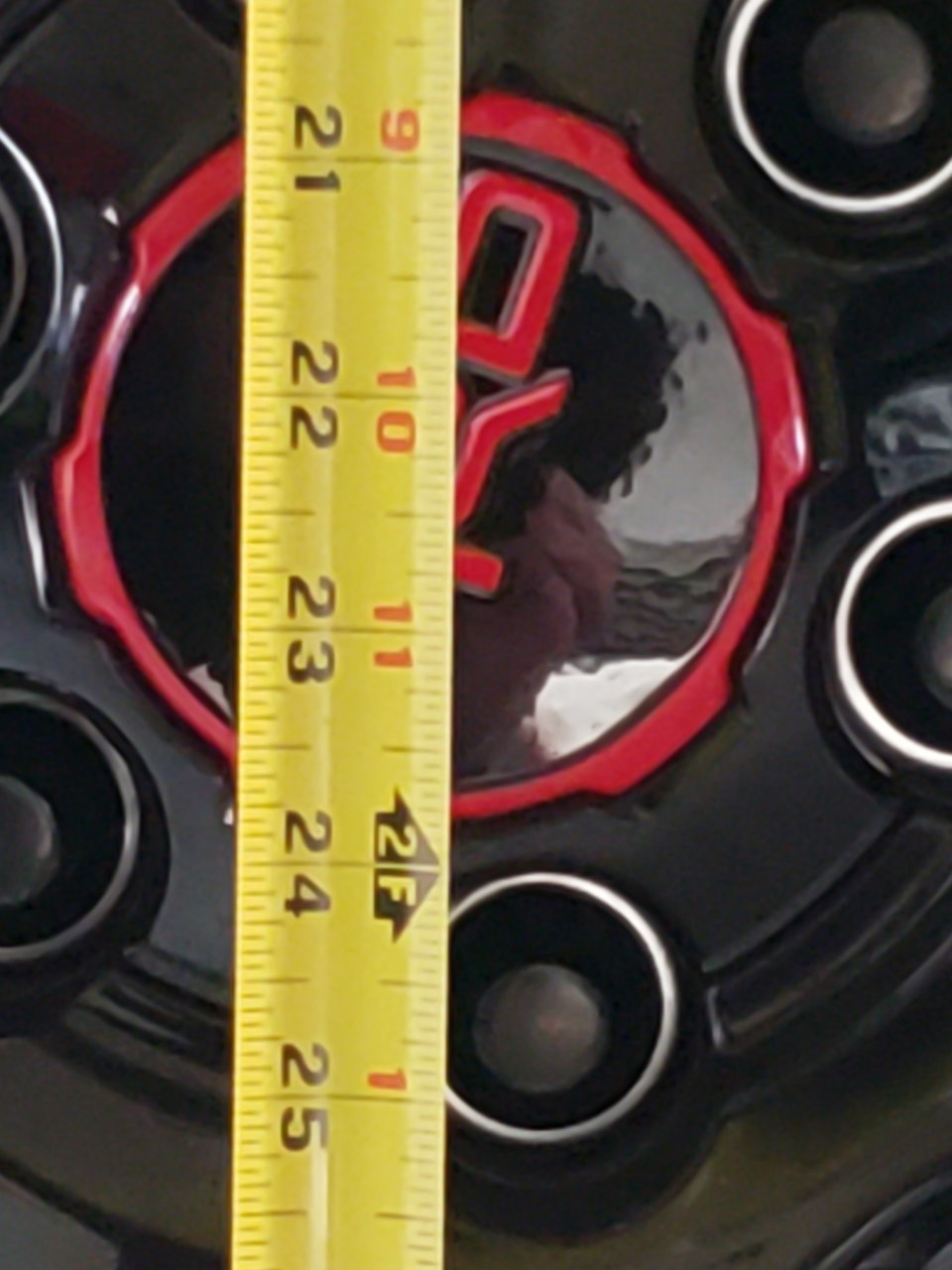

    Here is 5100 w/885 on 0 setting.
    I have ~22.5" hub to fender.
    AAL in the back at ~23.5.
