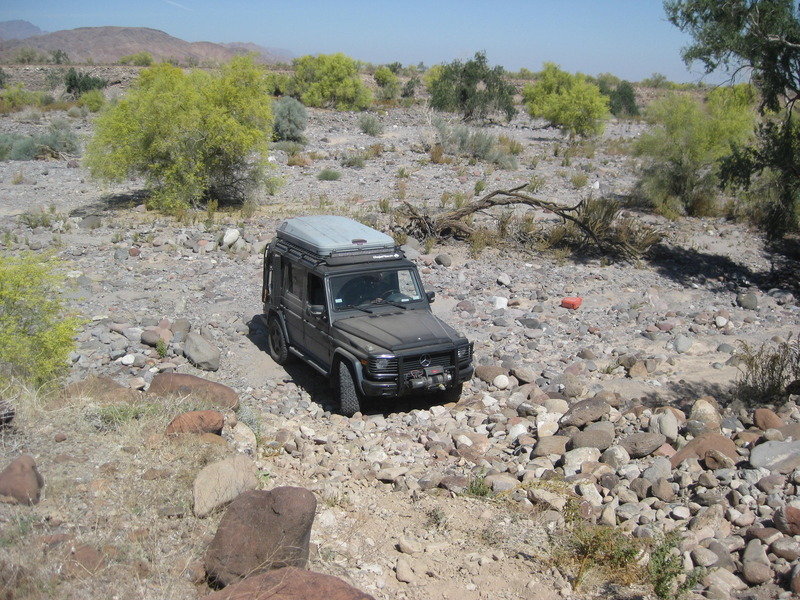

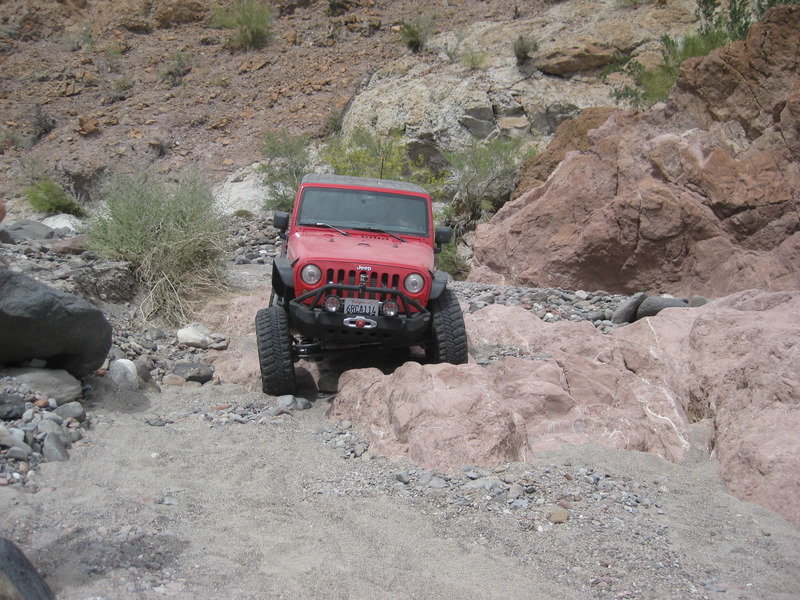

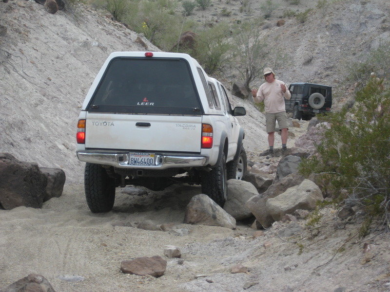

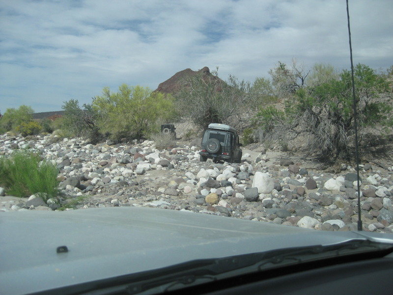

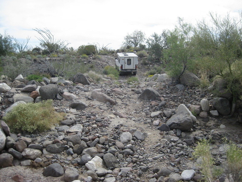

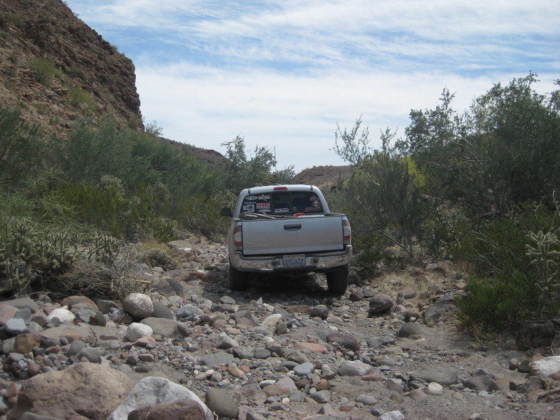

    I don't say bad things unless provoked... and then not bad as I read other's comments. I wasn't the one banned, after-all. I only wished whipper/lobster would have met me so we could wheel together and I could show him how to use the A-TRAC. In his video clip where he says it proves it doesn't work... it didn't, but hearing the engine, there was no consistent application of the accelerator to crawl over the little bump his tire was up against. I have never had such a capable 4WD as my 2010 Tacoma... never prevented me from getting any place I wanted, and never been stuck with it (and I have tried).
    Last month in Baja California, some photos of the road I took it on with 11 other 4x4s:
