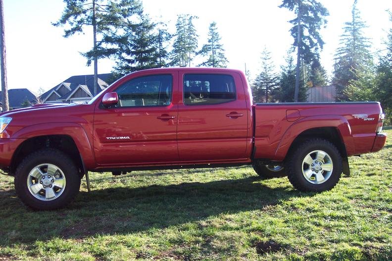

    Not with 16", but 17" wheels, 265/70-17 (approx 32"), after the OME lift
    Before the lift
    P.S. Pictures were taken a year apart.

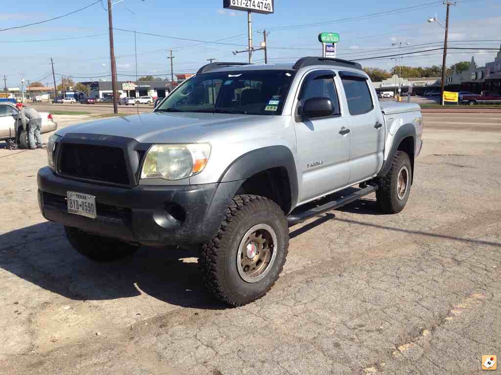

    bilstein 5100's with OME 884's 3" lift with 255/85/16's (33's)
