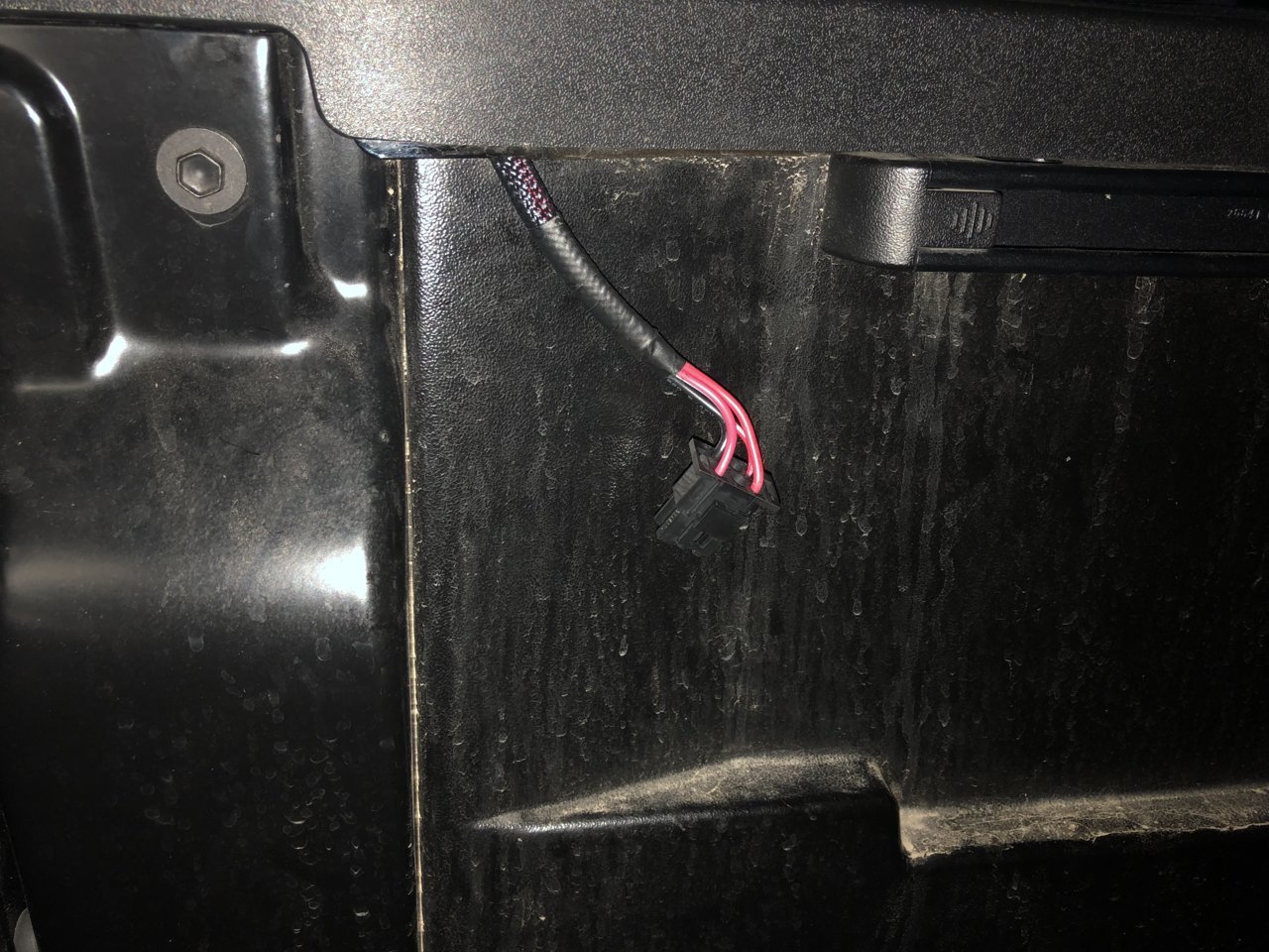

    Just removed my SnugTop and not sure how to protect exposed wiring for the third brake light. Does anybody have experience with this?
    Thinking about just taping a bag around it and calling it a day but thought I would run it by you guys/gals

    I'd personally probably not give af about it tbh. But if I decided to give af, I'd probably just saran wrap it and call it a day.

    Depending on the connector, sometimes you can get a cap for it. Otherwise you could tape it, or put a balloon over it or something.

    I'd tape it up so the plug side is down and call it a day. Maybe throw some electrical or gorilla tape over the plug while you're at it.

    I’m an electrician,if it was bare wires I may be more worried but seeing as they are in a harness It’ll be fine regardless. Just tape it up somewhere it won’t get messed up or crushed.

    Can you tuck it under between the bed and metal rail after taping the ends to keep dirt out? They will be more out of the sun and weather that way too.

    Pack some dielectric grease in the contacts and wrap it up in 3M 33 electrical tape.

    Drill a hole and install a bulkhead connector with a cover. No exposed wires to get snagged. No saran wrap.

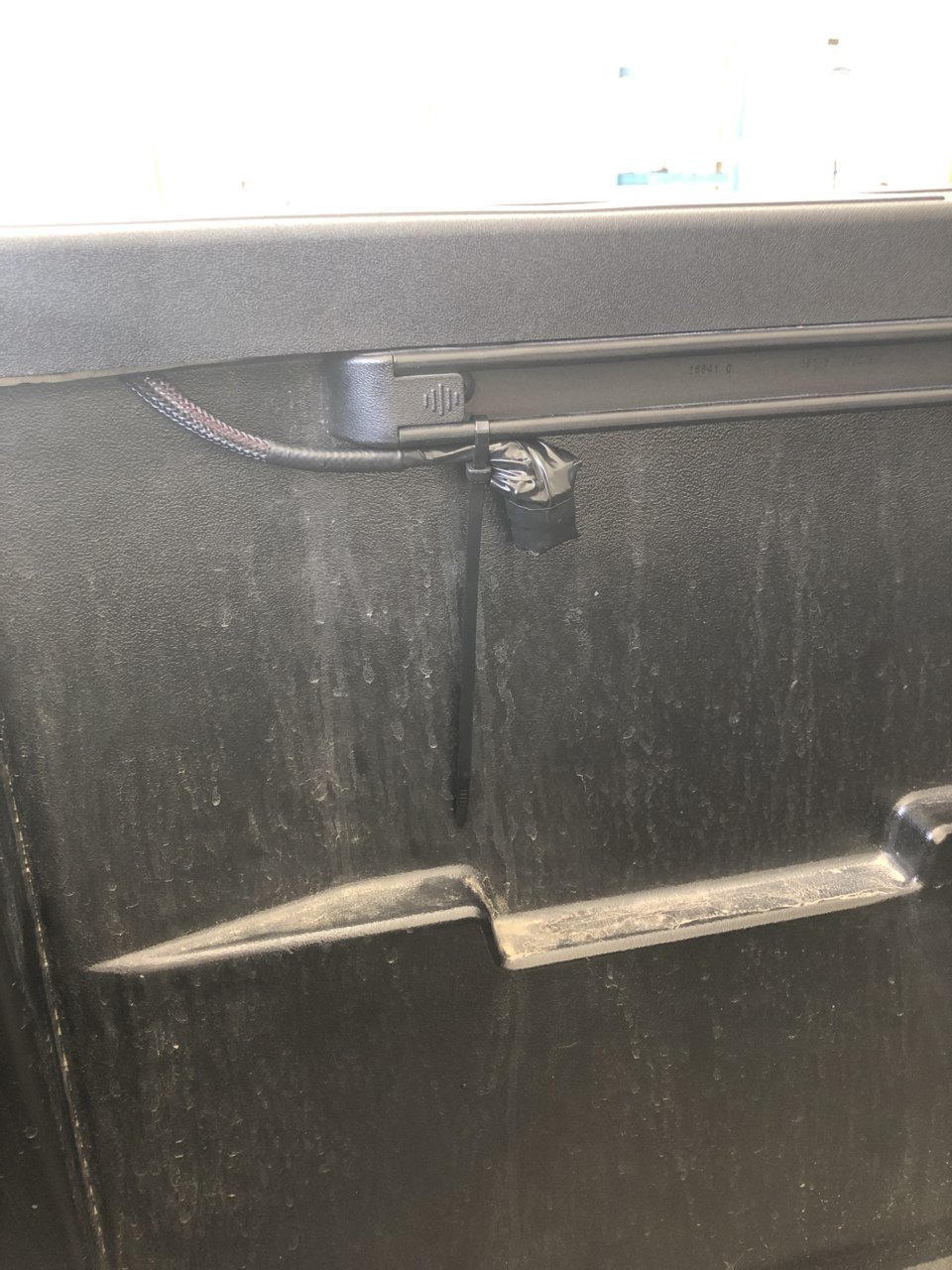

    Alright so I blended y’alls advice and stuffed the connectors with dielectric grease, wrapped the hell out of it with electrical tape, and zip tied it with connectors facing down. Thanks for the advice!
