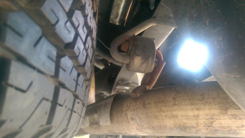

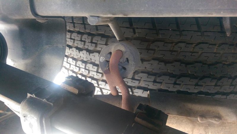

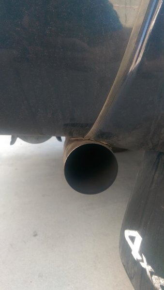

    Just gave mine to a buddy. Looked at his exhaust and the last rubber bushing holding it to the frame had the pegs installed/sitting the wrong way. The peg for the exhaust was on top and the peg coming off the frame was on bottom. Subsequently the exhaust was higher in the back and had melted a crescent shape into his body. lol looks like he'll be taking a trip to the dealership to see what they can do. I'll post a pic.

    I may be missing a bigger picture here, but from your pictures...it looks like you can just rotate the rubber hanger a full 180, laterally. That way the exhaust pipe hanger us underneath the body hanger.

    He totally can. But we were wondering how it got that way and stayed long enough to melt the plastic.
