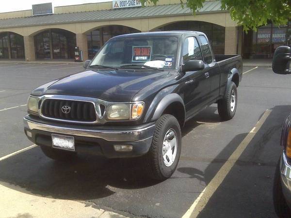

    Here are the pics I had taken earlier. They are not much but its a start.
    The window tag said 212,000 miles
    I'll take more when I go by it again.

    for 9000 i would look for a lower mileage truck too...but if you got him down to say...5000 it might be worth thinking about

    Yeah if I go for this one I would definitely try to talk him down to around 5000. As soon as I got back I looked at kbb and saw it was over priced. If I were to seriously look at this truck what kind of wear should I look at/ any parts that may need to be replaced soon? I did notice it is a manual tranny. How long could I expect the engine to last?
