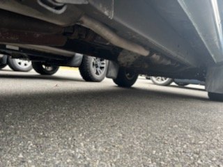

    TRD OR AC SILVERSKY 15
    CarFax reveals it is a NH and MA rig it’s whole life. Just sold at auction to VA dealer. :eek:

    Try and get a truck out of Arizona California or Nevada would be ideal lol

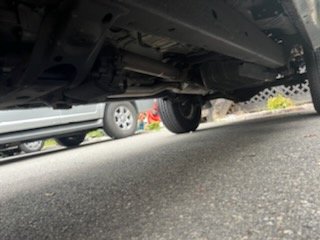

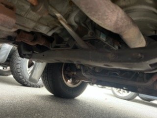

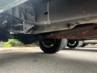

    Frame coated would not be a deal killer to me.....just have to tap on it and super close inspect....
    would look real close at the lower shock mounts.....front and back......rust hot spots.....
    Pics can only tell so much....need to lay hands on.....
    I've seen the ones with the replacement frames......and some think they will never rust again....
    WRONG.....bunch of them are even rusting away....some very fast......
    So if you get a replacement....and then dont paint it......
    Mine had basic flash rust here and there......
    ......but since prep'ed and coated several times over last few years.....
    looks kinda rough from zapping many times with a rattle can.......but no chance of rust....not on my watch.....
    even the O2 studs are coated in high temp anti seize......
    My guess is that is a replaced frame.....that they kept up.....
    obviously the leafs didnt get swapped......
    Oem suspension parts hold up well to rust over time.....
    some non oem stuff rust in double time......inspect....
    mevotech comes to mind......

    This is a tell and very suspect. There isn't a reason on the planet this truck should've sold at a dealer auction except that there are issues. When is the last time a solid no issue Tacoma no matter the miles needed to go to auction.

    yes this looks super sus

    Pick hammer the frame.
