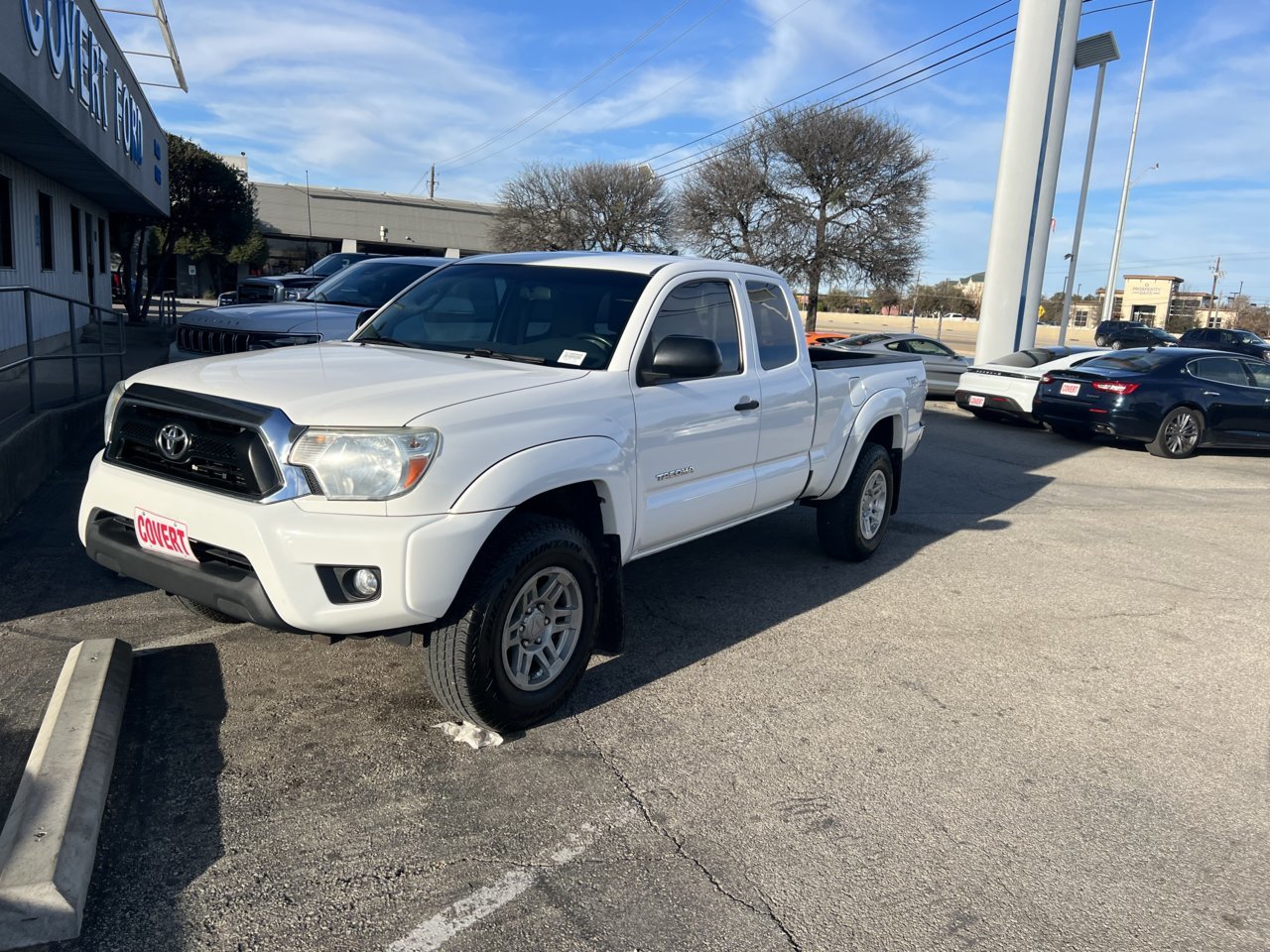

    Well I found a 2015 access cab 4x4 V6 auto. Can’t pick it up until Monday but I’m pretty excited about it.
