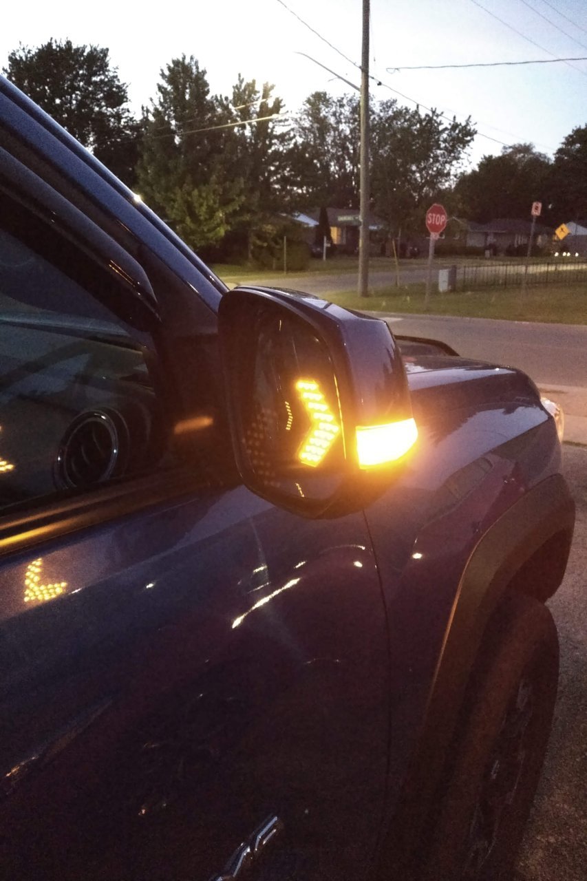

    Those look nice! And they are a bit cheaper there. Where is that company based out of? Their website doesnt say. Did you buy the big turn signal as mirror as well or just the backpart of the mirror?

    It is an Asian based company but does have distribution in the US.
    The mirrors with the embedded LED sequential arrow are tinted to reduce glare and are convex so they show a wider angle to the sides of the truck.
