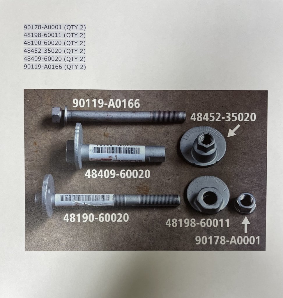

    I am finally pulling the trigger on upper and lower control arms. I plan to order JBA for the uppers but I am not sure what is needed for the lowers.
    I'll get OEM lowers that come with a ball joint and bushings. What else is needed for installation? My current alignment cams are frozen are there replacements available?
    I really appreciate the help.

    OEM cams are best

    Good deal. I've been looking online trying to make sense of the parts diagram for the adjusters. I just can't figure out what the hell I need for both sides!

    Just thought I’d update in case someone stumbles across this thread and is looking for the correct replacement LCA hardware.
    Thanks again for the help everyone.
