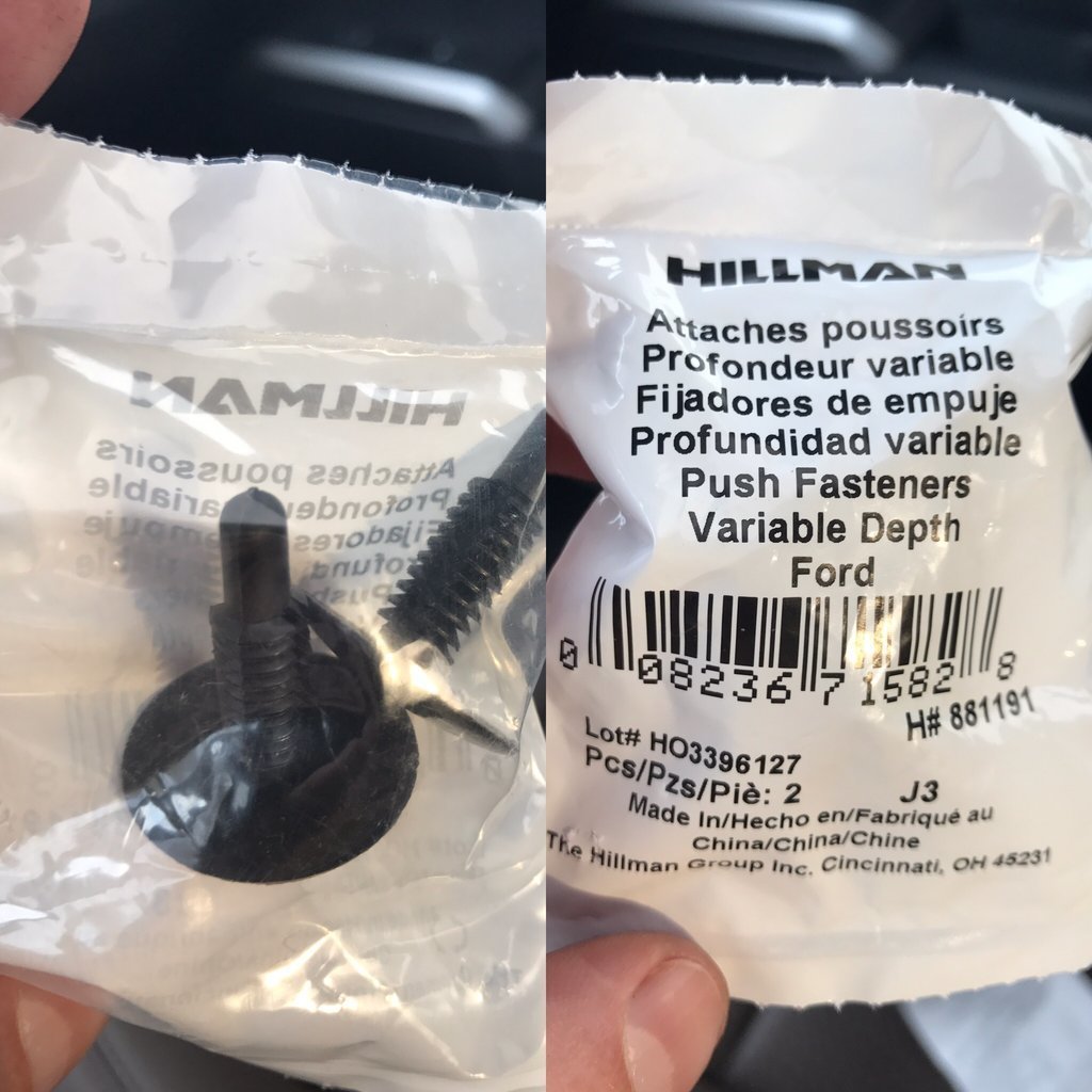

    Here you go OP, too easy, and they’re cheap, try Home Depot. I found these on similar threads, recommended by others here on TW.
    Urbin11[OP] and zoo truck like this.
