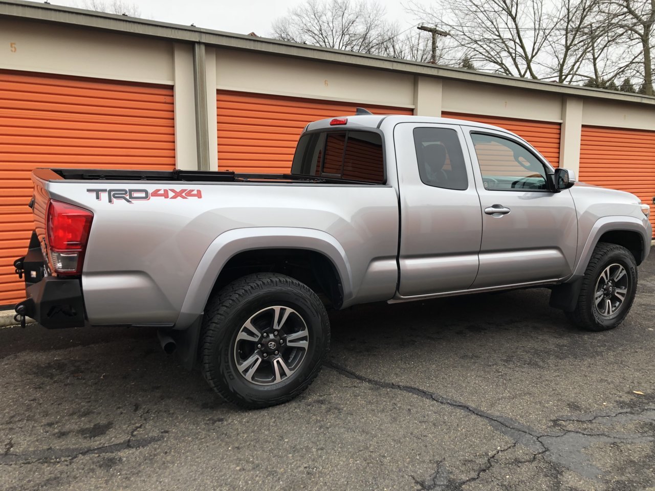

    16x8 FUEL BEAST 265 75 16 FALKEN WILDPEAK AT3 Tyger step sides 20% tint front to match factory tint bilstein 5100s on third notch PRO grill
    Here’s everything else stock and third notch. Looks pretty dang level to me. Stock coils and totally stock rear end.

    This is exactly what i was hoping someone would post!! Thank you

    No problem. Just switched it last Thursday. Aligned fine and no vibrations. Did not do the ecgs bushing.

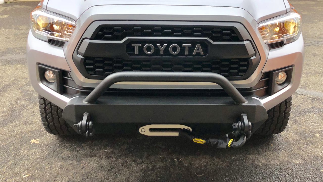

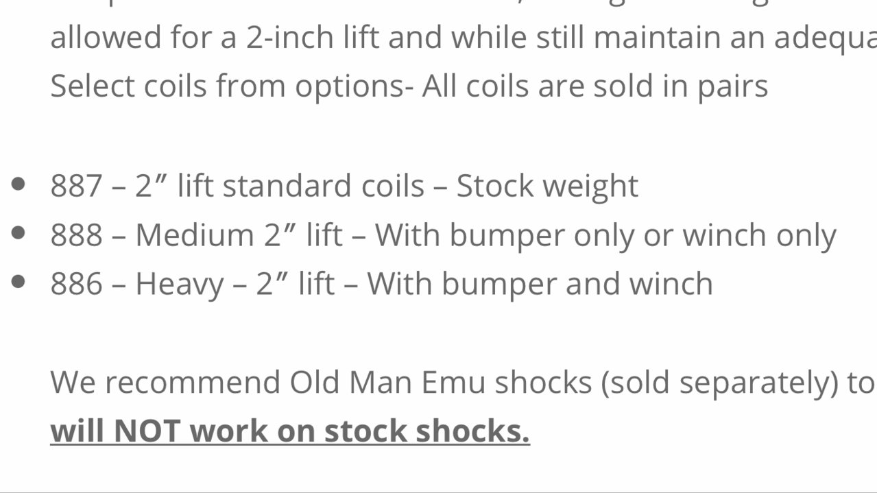

    I’m running winch and slim bumper totaling 150lbs, I’ve put on 5100s with stock coils and an AAL in the back and have rather large rake with 1.5” more in the back. Really only want a slight 1/2”
    Anyone know which OME springs to get and setup with 5100s and 150lbs on front to get 1” over stock height?
    Looking at 886 which says 2” with bumper and winch. So, I’m thinking 888s which should give 1”

    I’ve read 888’s will yield at 2” after settling or a little over. I think your best bet would be 887. What setting do you have the front shocks at? I have the same setup but with a 1” block in the rear.

    It says 888s medium 2” but with either bumper or winch not both so maybe 80lbs. I’ve got the 5100s at 1.1” on stock springs, but it settled back to stock height. And I have a single AAL in the rear.
    It’s a tough call, don’t want to do this over and over again. I’ve already put them in twice myself on the stock springs.
