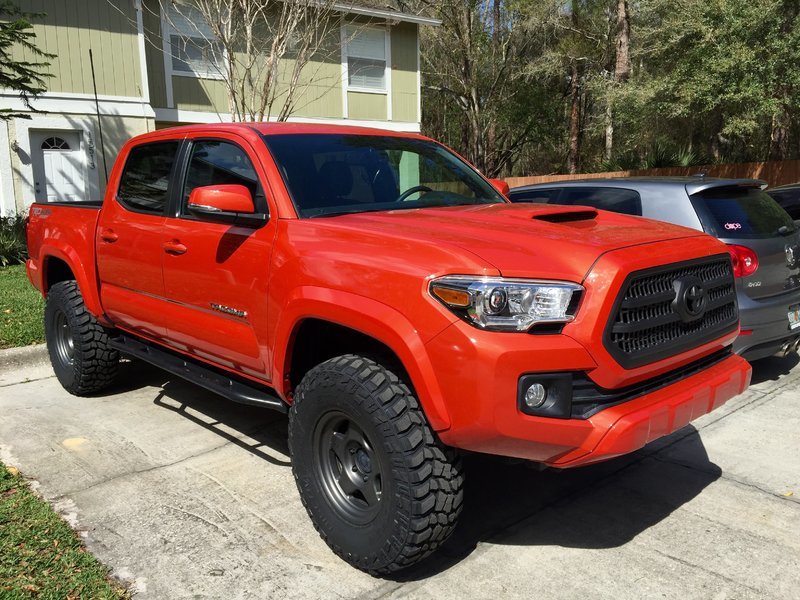

    I'm on a 3inch lift and just fit 285s with f5s with 4.5 bs. I off-road often and need to be able to stuff the tire. What should I expect to have to trim? Will be doing a CMC this weekend. Wondering about the wheel well liners or actual fenders.

    Looks awesome. You will hit on the front fenders probably infront and behind the tires cmc might not be needed.

    I'll be doing a CMC Saturday to be safe and will trim a Couple corners.
