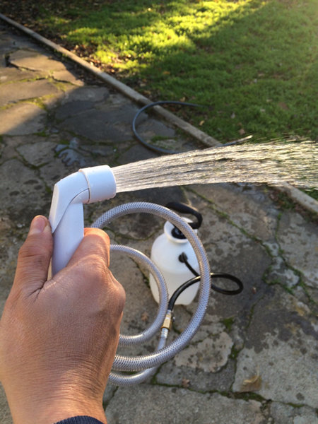

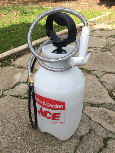

    i made one for less money. cost $29 i think.
    i bought a cheap ass fertilizer sprayer. two gallon capacity. attached a hose from the kitchen sink. (the one you use to spray off dirty dishes)..heat one gallon of boiling water. add to one gallon of cold water..= 2 gallons of very warm water. pump and wash. the thing is bad ass.

    BOOM!! found my pics!!

    that works!
    Once nice thing about that battery operated setup is if you want to rinse something you can just cycle it back into the bucket with no loss in water.
