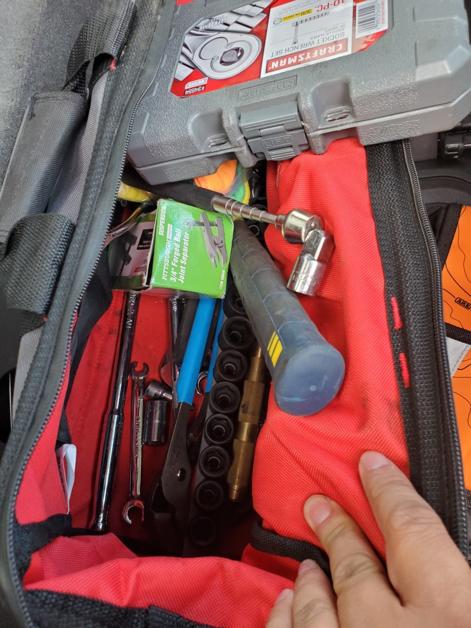

    @Emmetjmcc4
    Bad picture but went out and took one.
    Forgot I also have some wire cutters, pliers, and snap ring pliers with different heads to replace with (been useful), microfiber towels, ball joint separator, and other useful items.

    you should organize your Dad's toolbox and sockets for him so you have less trouble finding them!
    flare nut 'line' wrenches is on my wishlist so i can take my fuel filter off
    you must have one heckuva air compressor!

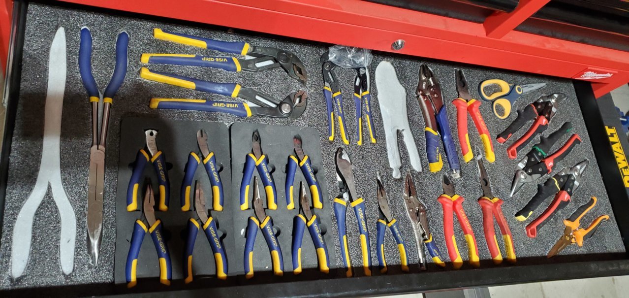

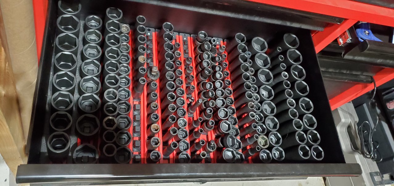

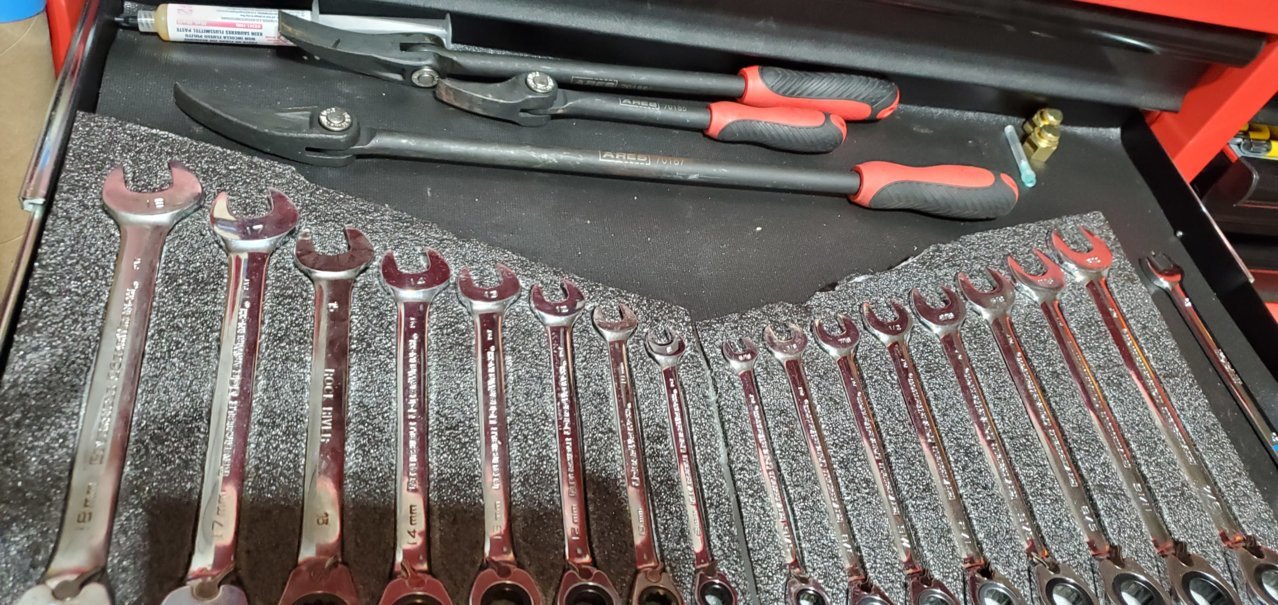

    Start with a good 3/8" drive socket and a basic set of regular and deep metric sockets. Add in a variety of pliers and spanners and screwdrivers and you'll be able to about 60% of DIY tasks. It'll take time to get your setup built up. Eventually, if you stick with it, you'll start getting tools for every odd job on your vehicle. For example, my 1/2" and 3/8" impact socket drawer alone looks like this:
    Notice that only a handful of them have seen heavy use, and you can probably point to them. 10mm, 12mm, 14mm, 17mm, 19mm, 21mm, 3/8", 1/2", 5/8", and 15/16" sockets here cover the vast majority of sockets you'll ever see on a vehicle (less axle nuts which I have a different set of sockets for). For pliers, I use the sliding channel locks, vice grips, needle nose, and bent needle nose most often. most often.
    A good set of Metric and standard hex wrenches will get you started and will work with most of the fasteners (less the bed and tailgate fasteners which are torx). I highly suggest you invest in a set of wrenches. Ratcheting wrenches are a huge help! I wish I had invested in the flex head combo wrenches, but I'll wait until I bash these things up a bit more. My 14mm is shot from heavy use (as yours will be too).
