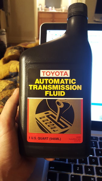

    Okay, so that's been addressed. I have a potentially more complicated question no one, not even the toyota dealerships in my area, have been able to answer:
    What is the difference between the pre '02 Toyota brand ATF (see attached pictures. Part No. 00718-ATF00), and the Castrol Transmax Import/Multi-vehicle ATF (see attached) that you can find at the various parts stores?
    I was told by one of the guys at the parts counter of one of the toyota dealerships in my area that the pre '02 toyota brand atf is the same exact thing as dexron III (3). I then read the back of the Toyota brand stuff and it says verbatim: "Formulated to replace Dexron II or Dexron III in applicable Toyota models."
    So, being that it says "Formulated to replace..." I would assume that there is something different in the Toyota brand stuff compared to Dexron II or Dexron III. Does anyone have any information to dispute this? I asked a guy at another dealership and he had no idea. I also asked a guy at Autozone and at O'reilley's and they had no idea either, and I haven't been able to find any information on the internet.
    Basically, I bought three quarts of the Toyota brand stuff at $10+ a quart, and the guy at the dealership mentioned that its the same as Dexron III and it's probably a lot cheaper to go that route (because I need to purchase more qts to do the drain/fill multiple times). I just don't want to mix them together unless I know for sure it is the same thing, or if it would hurt if I did mix them. I'd prefer to use the best stuff in the end, so even if that means spending an extra couple of bucks per quart, I'm fine with that.
    I also don't know what type of fluid is currently in my Tacoma considering I don't know what the previous owner put in it, or if it was done at the dealership a long time ago. So I don't know what kind of ATF cocktail is going on at the moment, or what potential problems it might cause.
