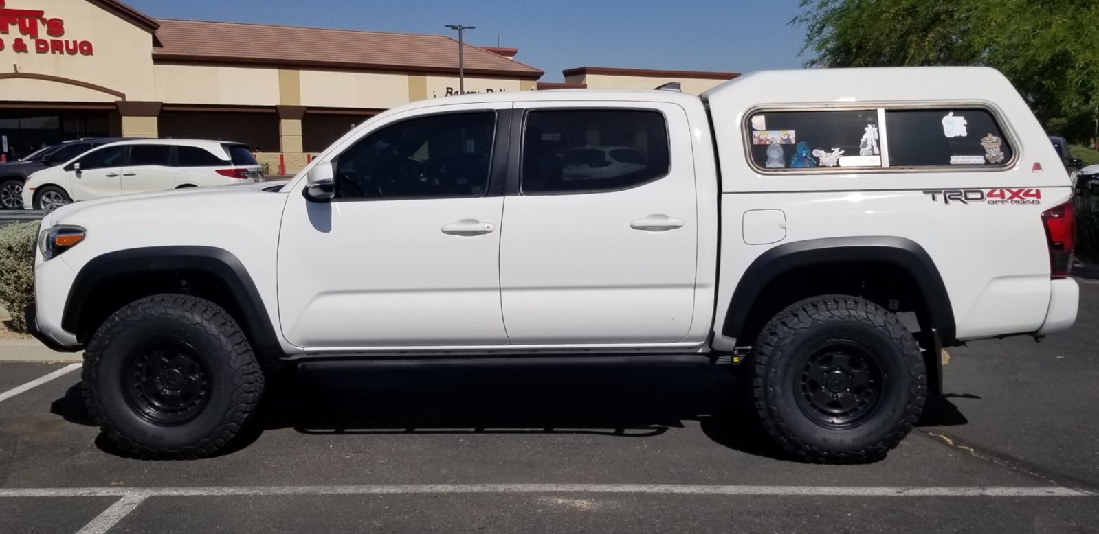

    FOX IFP front 2nd clip 1/2" spacer, FOX 2.0 adjustable resi rear, RXT leaf pack, SSO slimline front w/ baricade 9500lb and amber light bar, ARE Cap, allpro steps, TRD pro style wheels w/ Kenda Klevar skins
    3rd gen OR stock everything.
    Adding:
    fox 2.0 resi with adjusters
    OME heavy leaf pack
    Question is what travel length for the fox shocks? Stock 0-2" or 2-3"?
