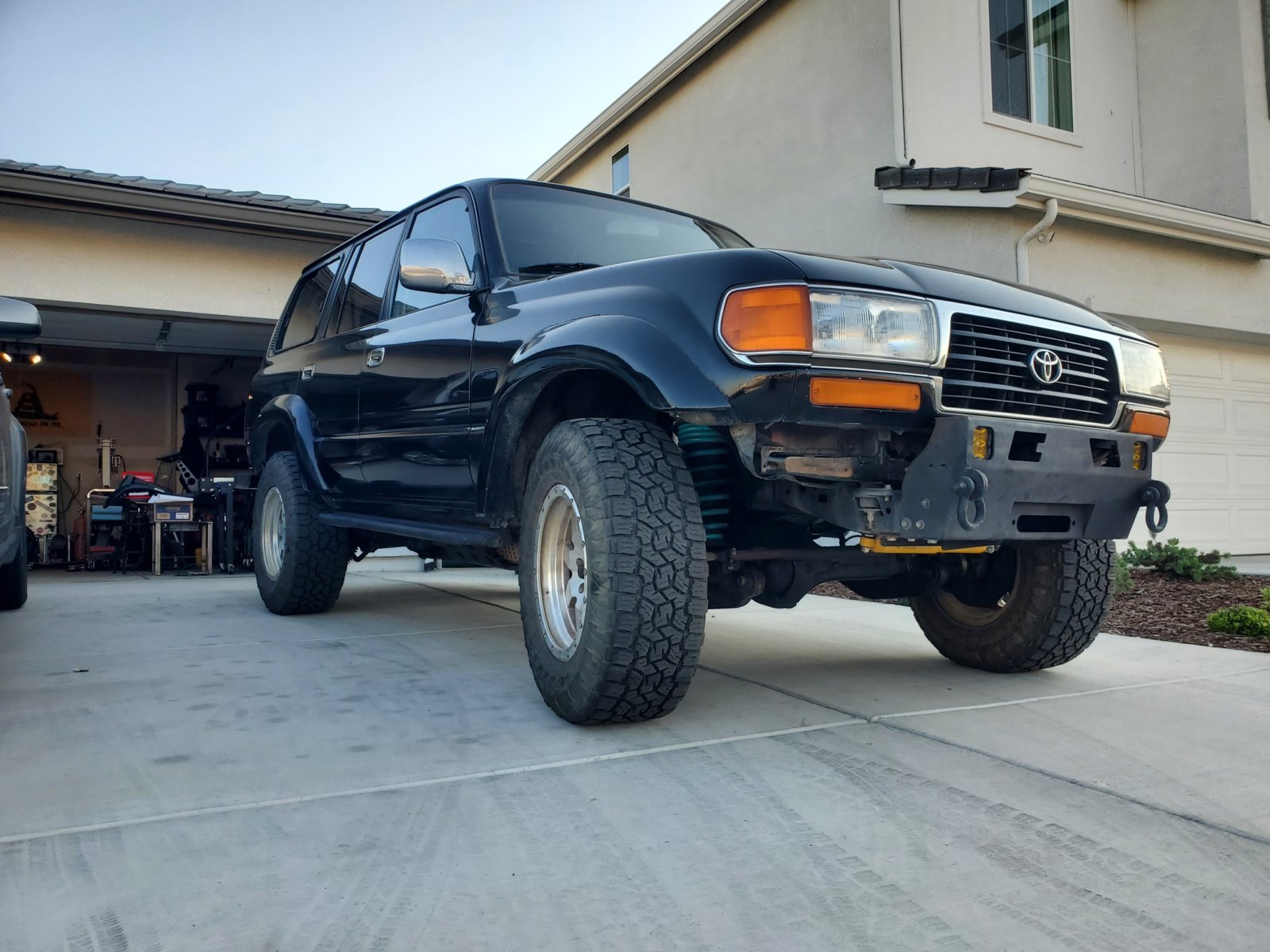

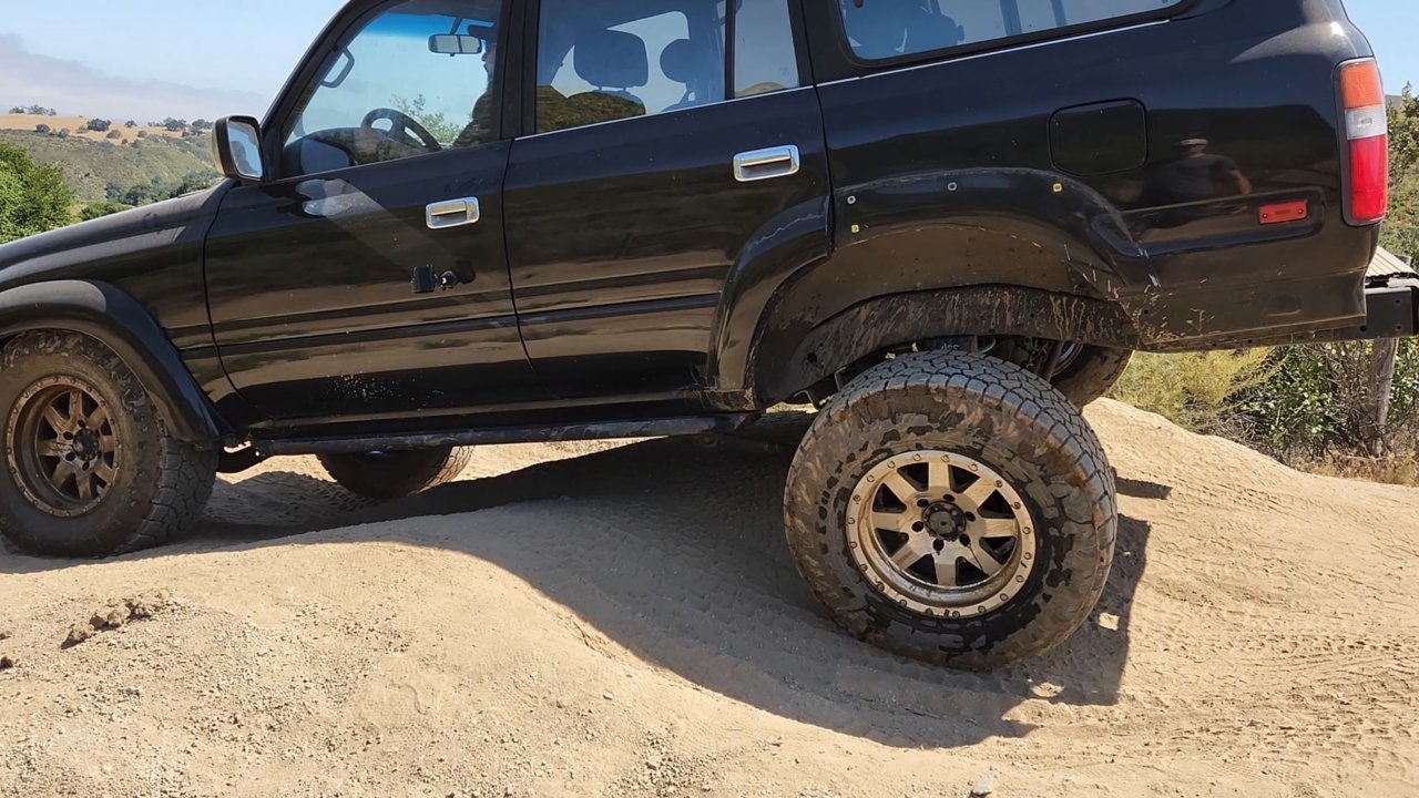

    80 flexes well in stock form
    There are custom arms available for more travel and if you want even more travel, go coilovers up front with some fab work
