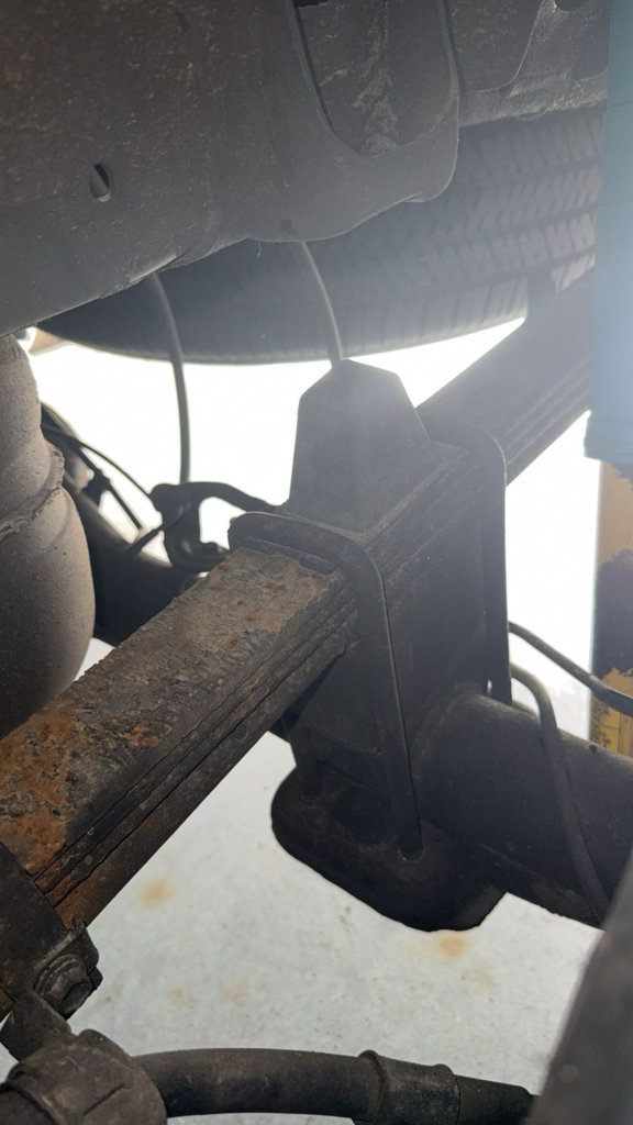

    We can't see the top of the front shock mount, but I'm betting there will be a big ole spacer in there. And you can see the block in the rear.
    Some folks call that 'lifting for looks'. As in the functional parts of the suspension don't change.

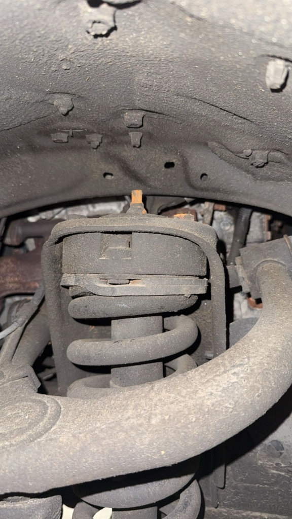

    Thanks for The reply, below I have attached a photo of the top of the front shock. so basically what you’re saying is that the blocks in the rear is what makes my truck lifted 3 inches pretty much. Also it says at about 10 in the back and 8 in the front so if I take out the rear blocks, will it set level? And is that safe to have no blocks or will I have to add something to substitute the blocks? Thanks for the help I’m new to this stuff . if I want to raise the front end by a few more inches to make it sit level with the rear instead of pulling the rear blocks could I just add in a 2 inch leveling kit in the front?IMG_1750.jpg

    You have front spacers (round blocks is another way to think of them) and blocks in the rear (rectangular spacers so to speak).
    If you take out the rear only you'll look like a dog dragging his butt in the grass and your headlights will shoot down planes.

    If you take out the rears it will squat like a pooping dog. If you take out all four corners, it wont hurt anything. You will just need a set of new U-bolts to do it, and then a new alignment.
    Those are some pretty big blocks. If it were me, I'd reduce the size of that lift, but that's just me. I really don't like how a 3 inch lift handles. Either replace it with new coilovers and springs (preferred), or a set of 2 inch spacers (cheap).
    If you want to level it, you want your rear block to be 1 inch less than 2x your front. (On the front, that 1.5" hockey puck provides 3" lift. To level, you would want the rear lifted 2".) Again, you would need new U-Bolts, alignment, and headlight alignment. I personally despise the look of leveled trucks - its looks somewhere between broken and poser - but some people love them.

    It is not possible to lift the front of these trucks more than 3" (while hoping to not have immediate problems) unless you have a drop-down bracket kit for the suspension lower control arms (LCAs) w/taller steering knuckles (which your truck does not appear to have).
    Between 2" - 3" lift, the ride & handling starts to become choppier (this because of the steep angle the suspension control arms are pushed down to). Above 3" lift, you basically will have little or no suspension downtravel left, and your CV joint boots may eventually tear apart (the angle of steering tie rods isn't good for your steering rack either). Stacking leveling kits for more lift is obviously a no-no here.
    Removing the lift you have is only a matter of removing the spacers on it (and replacing the rear axle U-bolts), and yes, front wheel realignment (it's also possible you might have spacers lowering your rear driveshaft carrier bearing, which (if present) would need to be removed too if you de-install the lift). Then you can decide if you want to put something of quality on there, or leave it as it is (Bilstein 5100 shocks for a good inexpensive 2" lift, or a BDS 4" or 6" lift w/Fox 2.5 shocks & drop-downs if you want something more upper-end... There are also long-travel setups available, though these might not be well-suited for someone who's still learning about suspensions & lift kits).
