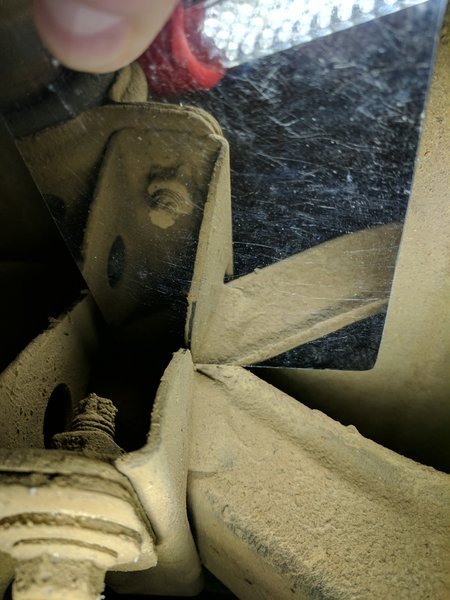

    Trying to install an OME FK29 and I'm probably a fucking dunce and I can't figure out what the nut is... The bolt is 14mm and it torques to 27 ft lbs.
    The nut? No idea. It looks square.

    Just went out and looked at mine.
    Those nuts are welded so no wrench needed :thumbsup:

    Mine were turning. Lol.

    Stand by while I try some wrenches...

    I'm thinking you're right and I just busted the weld. So I get to buy a new assembly for a couple hundred and get someone to install it. Thanks for the help, much appreciated.

    They're 14mm. I tried a 9/16 as well, it'll do the trick if you're stuck but definitely sloppier than 14mm

    If all that's wrong with it is the nut, don't waste your money on a new one... tighten it and it'll never bother anything. They're only welded so they don't need held when assembling, not for strength

    Good call that's what I did. Thanks.
    Still getting lowspeed vibes. Oh well. Guess I'll try the ECGS bushing next.
