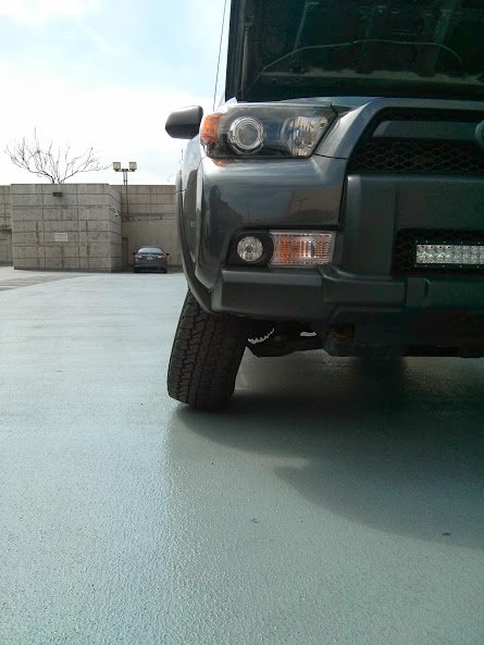

    I drive a combo of city, highway and mud/gravel backcountry roads. The arm didn't snap off, it just fractured at the weld/collar. I will attach the pic of it as it on the truck. SPC has sent me replacements as it was covered under warranty. They claim it was a design issue that has been rectified. We shall see. I have been away and will be replacing them when I get back.

    Pretty sure it was broke before we ever got to the place we were wheeling.. Just didn't notice it until we were about done for the day and noticed him backing up beside me and saw it moving. You can hear it clanking in this video when the front tire hits the ledge..
    Yea the bushings would definitely come out before welding.. The arms aren't a very thick material, maybe .083, Was kind of surprisedss
