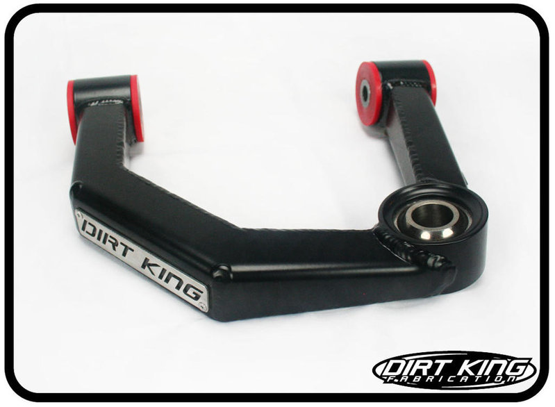

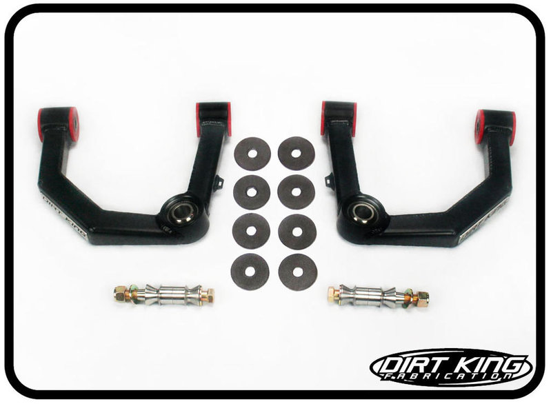

    We have our new boxed upper control arms for the Tacomas now available. They run $699 for the pair but we are having introductory pricing for the first run of them. Shoot us an email or message me directly for details.

    buy the Dirt King LCA's while your at it. Sooooo............sick!

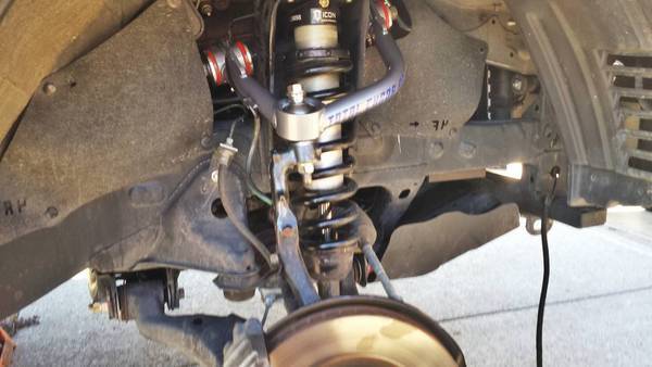

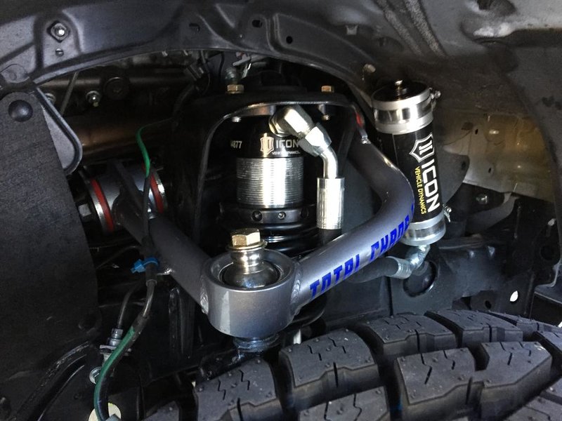

    As expected. The TC UCA install went smoothly. About an hour and a half to remove the LR units and put these in. The truck gets aligned tomorrow so I'll report back then with numbers, tire clearance and ride quality. So far I'm very impressed with everything from TC. Instructions were clear and strait forward. Future maintenance is well spelled out and the overall quality is impressive, especially when compared to the LR units. Oh and thanks to YodaDan at Wheelers for the great price and lightening fast shipping! Cheers!
