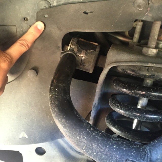

    The limitation in my mind was their early arms had fatigue issues. This is supposedly no longer an issue.
    D3662845-0E1A-4F3F-B234-19F32AFCD652_zps_1bef321c32ca726b6862cd7817015344482d1851.jpg
    But when you compare them to the TC/Camburg/etc the lack of the gusseting at the bushings is pretty obvious.
