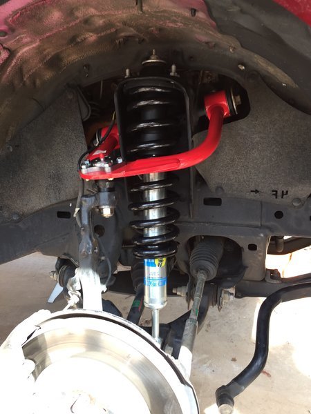

    20170301_145928.jpg I got the Freedom Off Road UCAs from eBay :anonymous:
