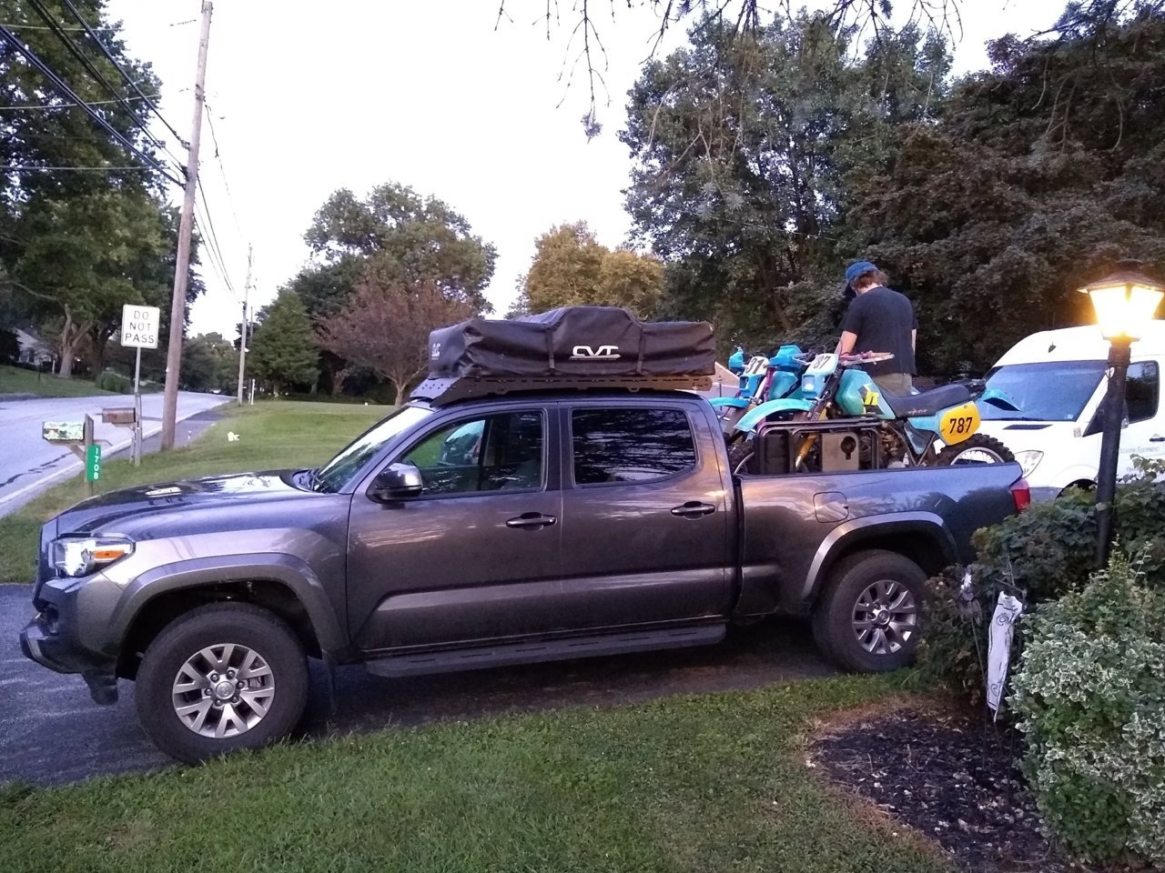

    You'll be able to do all the stuff you want with your truck as is. The only issue that may come up is the kayaks might poke the RTT. My set up is reversed and with heavier toys. RTT on roof dirt bikes in bed. Truck performed great. Good luck have fun. Check all bolts for tightness
