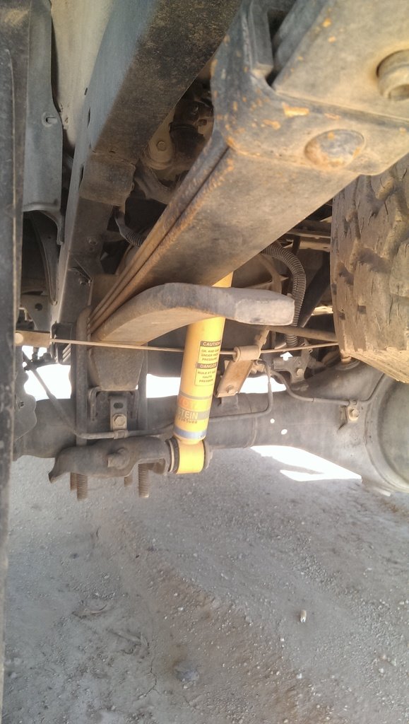

    I stand corrected but Dakars can and do sag.

    I think some ranchos give lift, can't remember which ones tho'....
    And below.....
    vvvvvvvvvvvvvvvvvvvvvvvvvvvvvvvvvvvvvvvvvvvvvvvvvvvvvvvvvvvv
    This OEM billy is maxed out for up travel with 2" block

    The quicklift ranchos use the 9000 series struch that gives lift

    Yeah I figured. My right rear shock is shot too. I've been thinking of just replacing the shocks with something cheap to hold me over until I can get the funds for a proper setup. Any suggestions?

    Weren't your fabcrap shocks upside down though?? Causing the harsh ride. Those shocks can only be run with the stem up.

    I don't really have any except go easy on road & no off road till you purchase new/extended travel shocks. Personally I ran Bilstien 5125's, love them...

    Nope, stem was up

    Are u running the 170/60 valveing or 255/70?

    im running the 5125s from wheelers. Their the 255/70 valving and they ride great.

    Ah my bad, we must have talked about how they aren't to be used upside down or it will cause a harsh ride I suppose... I remember something to that effect...

    255/70 is the norm for the length needed for Tacomas and in my opinion is too high. Rides like a sack of bricks when the rear doesn't have a load in it.

    Yea thats why I opted for the 170/60. Rides very nice paired with any spring, stock or aftermarket. Even with weight in back. Truck only weighs a little over 1600 lbs in the rear

    How did you find 170/60 valving in the proper length? I need to swap these out.

    33-186559. 11.00" travel

    Damn that's a little long for my setup without adding bumpstops, I'll have to look into it some more

    They do sell different size of shock. What size do you need?

    Right now I'm running 8.0 and 8.6 travel. 5125. Are you running 5100?
