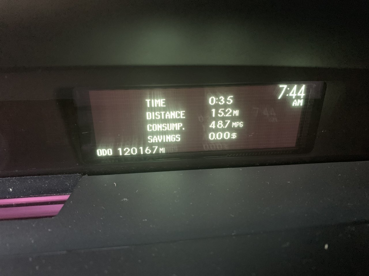

    You’ll find nothing bad here about the Prius, we’ve owned 5 of them and will continue to enjoy them. Don’t get me wrong I certainly love the Tacoma but for gas savings my money is on the Prius over 48mpg looks good to me with gas over 5 bucks a gallon.

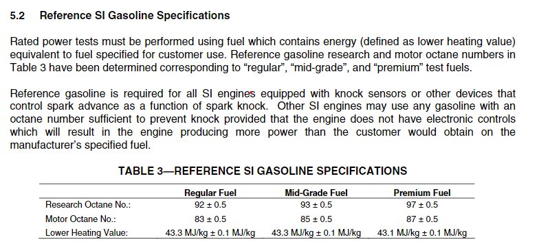

    There is speculation if it is 91 RON(87AKI) or 91 AKI.
    Since SAE J1349 was the test used to obtain torque and horsepower, I tend to think it's 91 AKI.

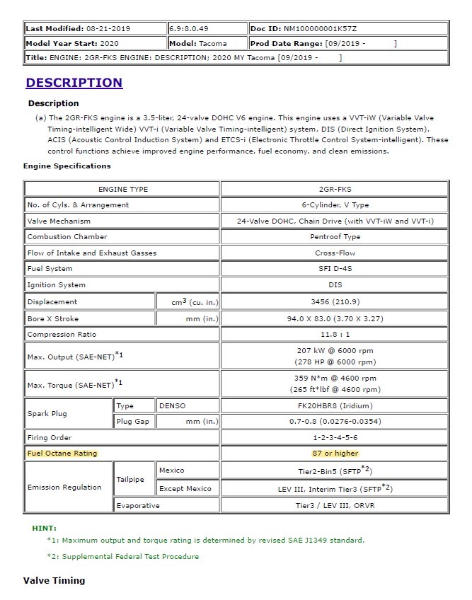

    i thought 87

    Huh...
    Hadn't seen the '20 version.

    This is J1349-2004 (don't have the current 2011 version)
