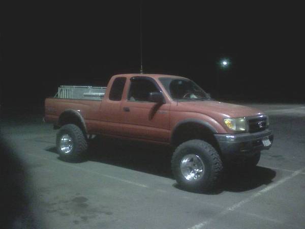

    I would just do OME all the way around.

    Mines a lil stiff now, as I made my own 12 leaf pack in the rear!
    and had to space the front to get Her a little higher.
