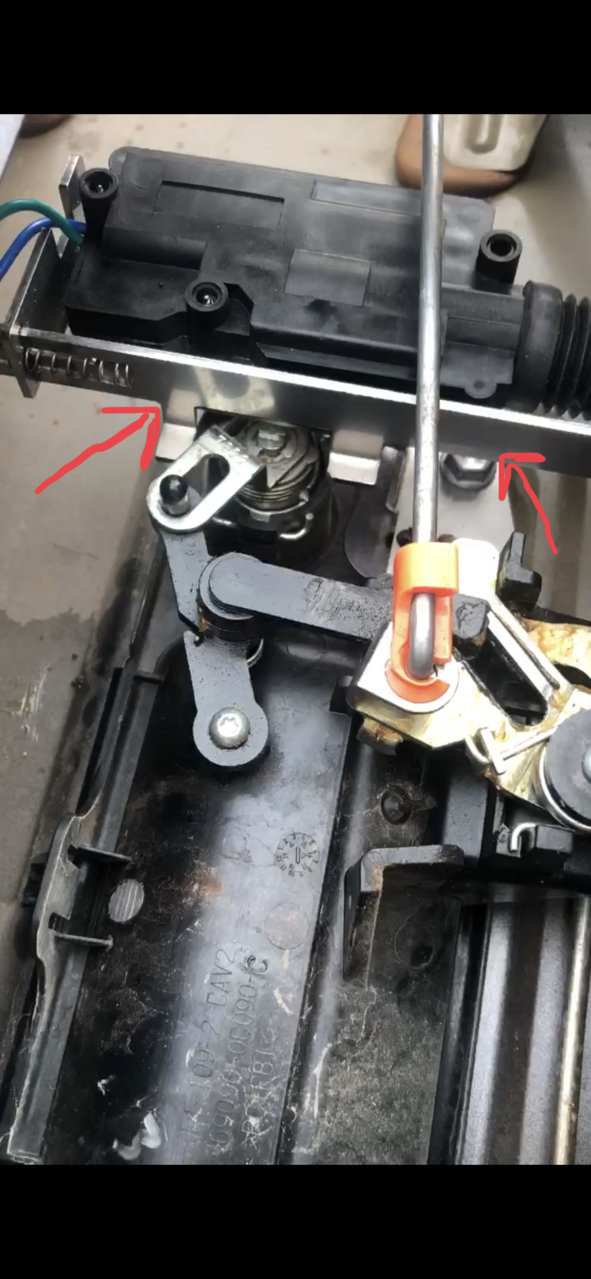

    Finally figured out the source of my weird noise.
    Pop lock was rattling
    I don’t know how to upload a video but here is the culprit
    I don’t know if there is a better solution because I haven’t looked into it yet but i just used a zip tie. It doesn’t move around now. And more importantly NO JINGLE SOUND!
    All the moving parts work just the same. I only snugged up the zip tie a bit. Its definitely a temporary fix.
    You’re probably thinking “how loud could that have possibly been?”
    Well it sounded like I was dragging a drawer of silverware behind me.
    Anyway I’m happy :)
