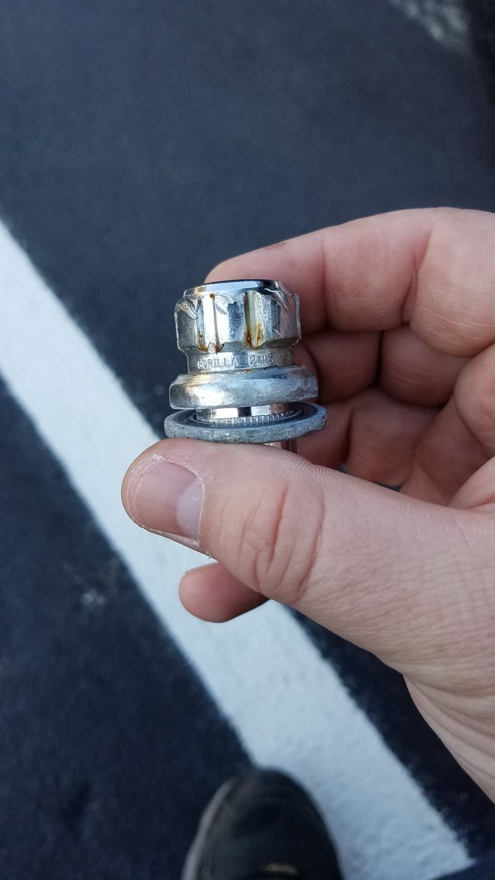

What Wheel Locks are these?

    My TRD "beadlocks" have a splines lug nut similar to that. There is a special tool that is required to remove them.

    Twist socket

    Twist off sockets
    Irwin, usually Advance Auto should have them

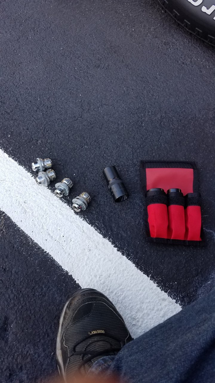

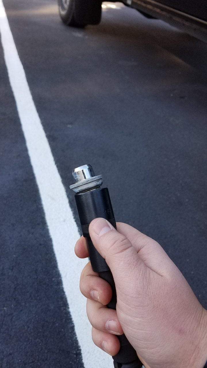

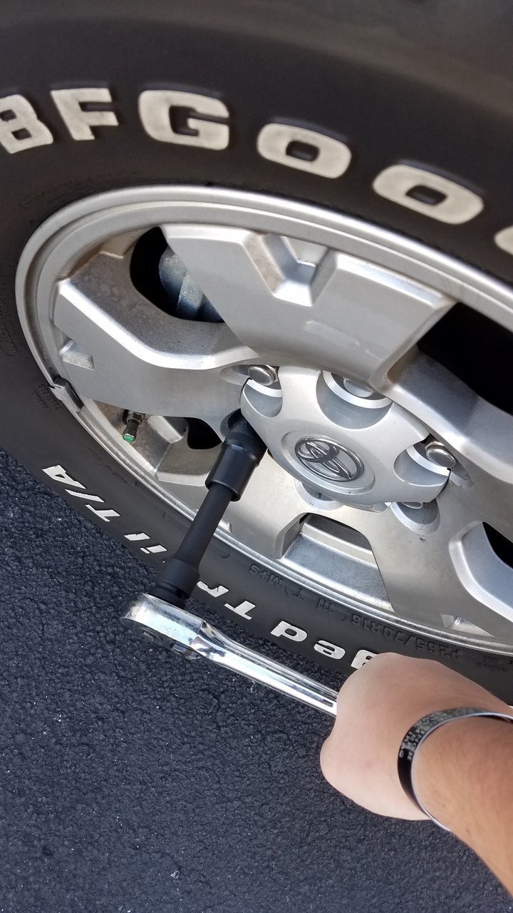

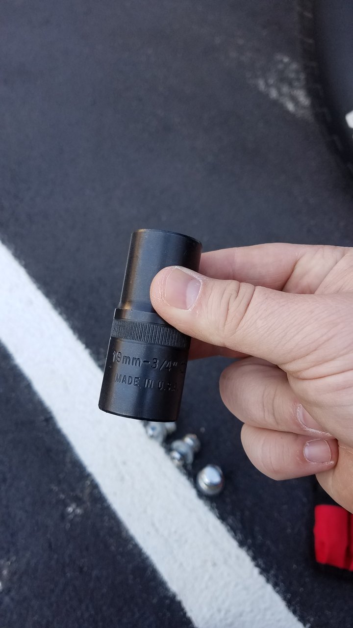

    Well, Sears had a kit that just so happened to work. Be advised, if you do get the craftsman kit, you'll need a 1/2" extension, which all I had was 3/8" extensions. Pretty easy. Once it came out, just smacked the lock a bunch with the socket wrench till it popped out of the removal socket.
